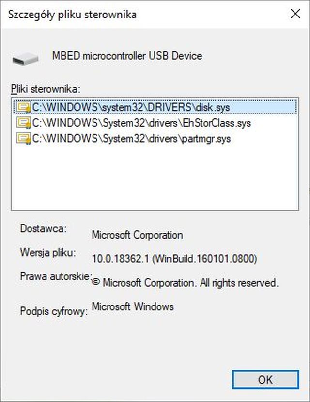

My development board "NUCLEO-401RE" has forgotten the original name of the virtual disk.
AZakr.1
As a result of various projects, the original name "NODE_F401RE" changed to "NUCLEO".
I do not know when.
The board is working properly.
However, the Teseo-Suite Pro application selects the firmware to program the board based on the name of the virtual disk - in function (Update my STM32-NUCLEO board for X-NUCLEO-GNSS).
I can't upload the correct firmware for my Teseo-Suite Pro project with NUCLEO-401RE and X-NUCLEO-GNSS.
I can't restore the old name ("NODE_F401RE") of this disk.
I tried upgrading the firmware for ST-LINK on the NUCLEO board.
I tried downgrade the firmware for ST-LINK on the NUCLEO board (various versions and periods).
I tried formatting the virtual disk through windows (xp, 7, 10).
Unsuccessfully.
Please help.

Pavel A.
How does it look in Device manager and in "Devices and printers"?
How does it look in diskpart (detail disk) ?
-- pa
AZakr.1
Did you ask about this information?
Description - Disk drive
Manufacturer - (Standard disk drives)
Model - MBED microcontroller USB Device
Bytes / sector - 512
Loaded media - Yes
Media Type - Removable Media
Partitions - 1
SCSI bus - 0
SCSI logical unit - 0
SCSI port - 0
Target SCSI device ID - 0
Sectors / path - 1
Size - 544.00 KB (557 056 bytes)
The total number of cylinders - 1 088
Total number of sectors - 1,088
The total number of tracks - 1 088
Tracks / cylinder - 1
Partition - Disk # 5, partition # 0
Partition size - 544.00 KB (557 056 bytes)
Partition start offset - 0 bytes
