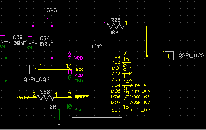

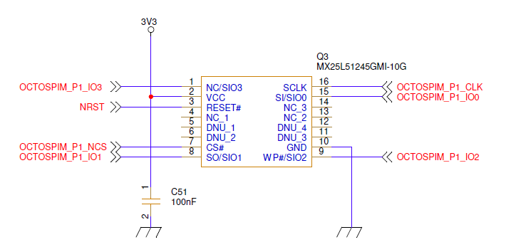

Hi everyone,
I'm working on a custom display board with a STM32H7A3ZI MCU. I have the same QSPI Flash than the STM32F769I-DISCO board, which is the MX25L51245G, except that I use the 16 pin package for my custom board. The H7 has an Octospi interface compared to the F7 which has a QSPI interface.
I have set the OSPI interface of my H7 to QSPI mode to have the same board config.
Here's my hardware schematic :

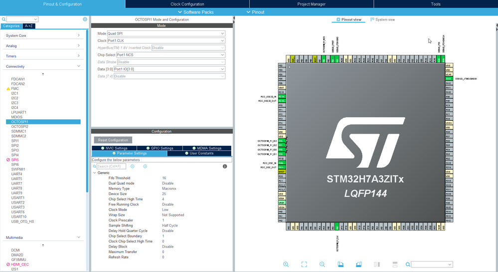

0693W000007EHVvQAO.pngAnd the MCU pinout/config with the OSPI :
I'm struggling with the external loader and getting the QSPI work. I'm a beginner with QSPI/OSPI flash interfaces.

1) On my project with CubeMX, I set the octo-SPI to QSPI mode, with the same parameters used on a random STM32F769I-DISCO TouchGFX template example, except that I have dedicate RESET pin and my QSPI clock is set to 83.5 MHz (with prescaler)

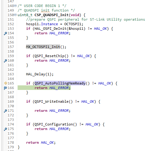

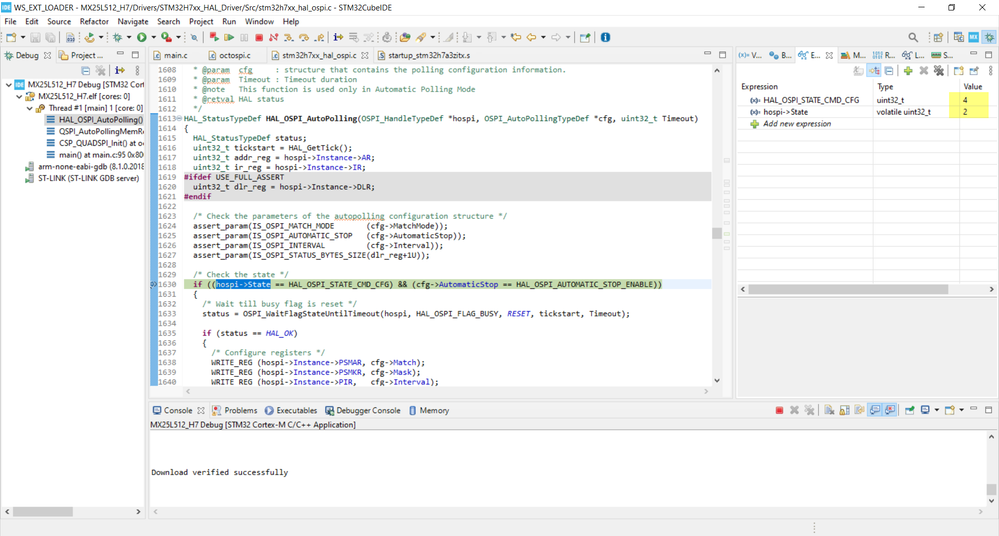

Thought, the debug fails here:
I wanted to check with you if my config was correct and if I missed something/mistaken somewhere.
