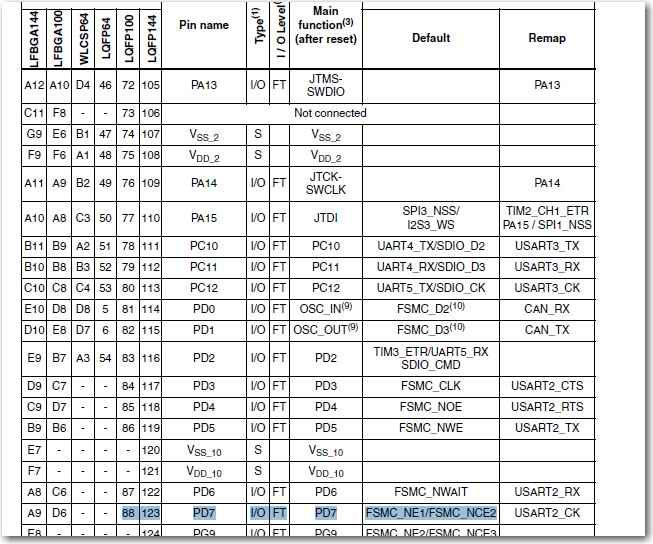

How can I multiplex SRAM,NOR Flash and NAND Flash on PD7 ? It's function as PD7 FSMC_NE1/FSMC_NCE2 on pin 88 for STM32F103VCT6, is it configurable via software or I need to put a latch / multiplex chip for it ? Any examples for it (schematic)? What's the common application for NAND flash ? Can I run my code from NOR Flash ? I saw there's boot option ''System memory is selected as boot space'', page 48 STM32 reference, chapter 2.4 Boot Configuration... Thanks #fsmc- Labels:

You'd probably want to gate it with a high order address bit.
System Memory is the OTP ROM at 0x1FFFFxxx, and which contains the system loader. You'd have to put some start up code in Flash to configure the external bus before you could execute-in-place off the NOR device, and this would run slower on the external bus.Up vote any posts that you find helpful, it shows what's working..

Do you have a reference / example for schematic on using NAND and NOR with SRAM for STM32F103VCT6 ? The one I saw on ST3210 Eval is for STM32F103ZET6...

Does you part have the FSMC? If it does aren't the pins used materially identical?
‎2014-04-25 8:10 PM
Get the data sheets and work through the pin lists.
http://www.keil.com/mcbstm32exl/mcbstm32e-base-board-schematics.pdf

if I have 512x16 SRAM, it means I have 1 Mbyte of SRAM ? so if I want to have 4 Mbyte I can use 512x16 SRAM, 4 pieces, correct me if I'm wrong, thank you- Mark as New

For multiple devices you'd either want to add your own decoder on the high order addresses, or see if the CSx provided by the STM32 are usable. In the old days you'd use something like an 74LS138 Renesas has a 64Mbit (8MB) part R1WV6416R, there might be othersUp vote any posts that you find helpful, it shows what's working..

I saw on STM32F103VCT6 Pin 88, PD7, FSMC_NE1/FSMC_NCE2
