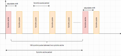

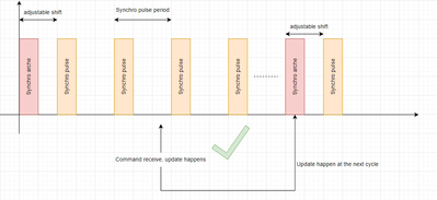

My aim is to make two PWM signals like this :
The red signal is named "synchro arch" and the orange one "synchro pulse". Both have their own duty cycle, the period of synchro arch is 100 times the synchro pulse period and there is a shift (delay) between the two signals.
The duty cycle of synchro arch, the duty cycle of synchro pulse, the delay and the period of both timers are programmable using UART commands.

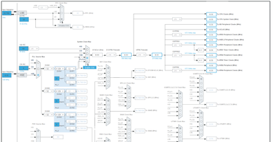

My MCU use two 32 bits timers (TIM2 and TIM23) and the USART3 to work. For the clock, I used the external clock of the ST-Link (HSE 8.33MHz).

- Does set HSE frequency to 8.33MHz in clock configuration in CubeMX is a good idea ?

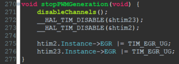

I stop the timers with stopPWMGeneration like this:

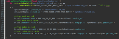

Then, I execute the setSynchroPulsePeriod function :
This function set the synchro pulse period AND the synchro arch period (by multiplying by 100).
When I set the ARR registers and recalculate duty cycle (CCR1), I restart timers with startPWMGeneration :
"Or do you still want 100 pulses and then the last one has a larger delay before the start of the next cycle? It's unclear in the problem statement."
While I have Tsa (period of synchro arch) = 100*Tsp (Period synchro pulse) it is good for me :)

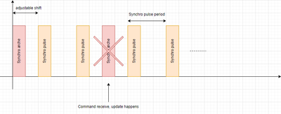

"The proper method will depend on what output you want, specifically, under certain conditions, specifically when things can be updated at arbitrary times. If you only allow changes at the start, or if you allow things to be temporarily out of sync for a cycle, it becomes a bit simpler."
Good point! I need to change all the values ... but I need that the previous cycle end and that the next cycle begin after. Indeed, I don't want that a synchro arch happen during the current cycle :
This case must never happen :
But this case is acceptable
So ... "last one has a larger delay before the start of the next cycle", the answer is yes

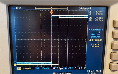

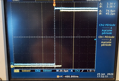

‎2024-01-25 8:23 AM
To illustrate my new issue, I take two photos:
The first one is when I sent 501µs to UART >
There is a jitter
The second one is when I sent 500.0804322µs to UART >
There is no jitter
The clock timer frequency is 8.33MHz, one is a perfect multiple of this (1/500.0804322µs) the other is not. I wonder if I've made a mistake in configuring the clock ... I don't know if it's really possible to set "8.33" like this :

To jitter problem:
Look at TIM2 ARR values in both cases. They are different (417332 vs 417299). But now look at TIM23 ARR values. In both cases are the same. That means that ration of period is not constant. In case of 500.9603842us you have exact ratio 1:100. But in case of 501us you have ratio 417333/4173=100.008 ! Don't forgot that your faster timer have limited "granularity" (frequency resolution) respect to your slower timer. If you want to fix ration between timers you have to count with frequency deviation due integer nature of ARR value.
