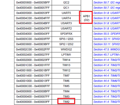

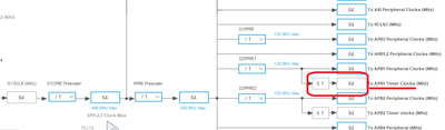

What is the frequency of timer2 which is of 32  bit with prescaler value 0 for NUCLEO-H755 board and how to check it ?
mƎALLEm
TIM2 kernel clock is generated from APB1:
From the reference manual:
In CubeMx:
That clock is devided with the timer prescaler

mƎALLEm
In CubeMx:
Divide it down and have in Toggle mode one of the TIMx_CHx pins associated with it.and measure it on a scope?
The clock tree should be usable to determine the base frequency.
