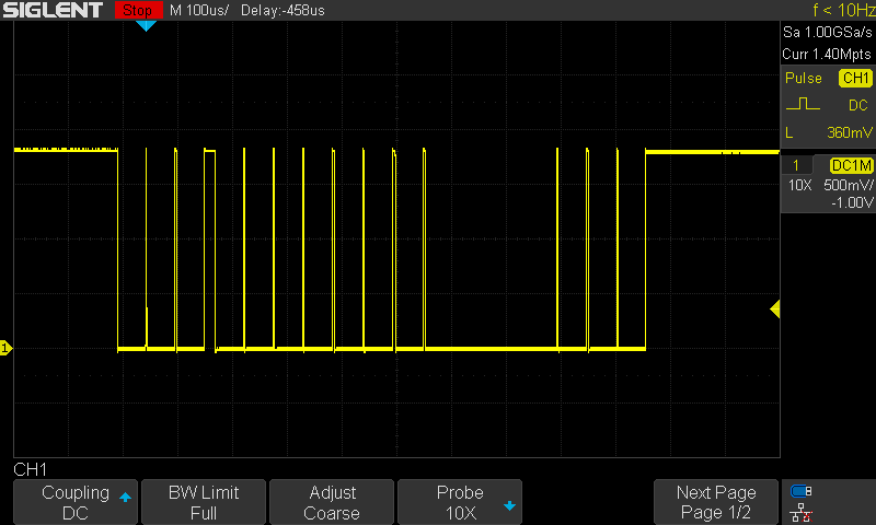

Why is MOSI on the oscilloscope so broken? How come I can even send correct messages with such a MOSI graph? See attached picture. MOSI has a rise time of about 2.5us. Which is way too long. Why? If it was because of the oscilloscope, I'd see the same phenomenon on SCK, NSS or MISO. But I don't.

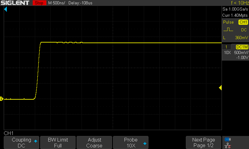

This is NSS - the rise/fall times would be way faster without the oscilloscope probe.

Regarding the MOSI scope thing:
If I select a finer resolution like 50us instead of 2ms on the scope, then I get clean edges and fast rise times of ~50ns. So it seems to have to do with the scope settings.

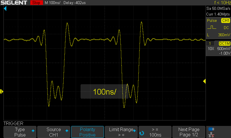

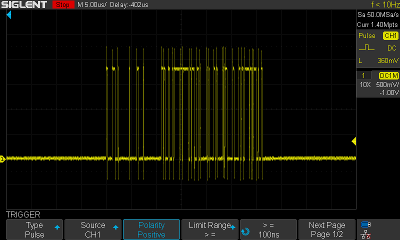

This is what MOSI looks like in peak-detect acquisition mode.
There is a pretty strong overshoot of 700mV and undershoot of -500mV.
A possible explanation for the missing bytes could be that maybe SCK is ringing. So some SCK cycles could be missing maybe? But that would not explain why waiting after pulling NSS low fixes it.
I think, the ringing could even be worse without the probe. Because the rise time should be much higher without the probe capacitance...

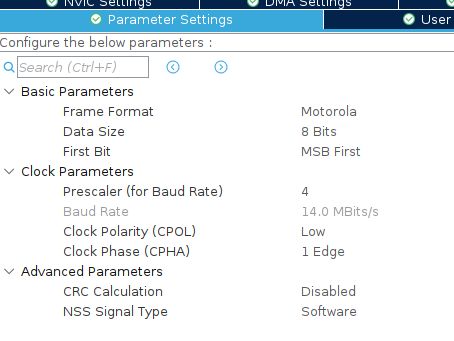

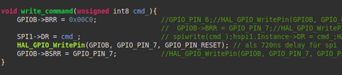

>I initialize a 60 byte array and do a 30 byte memcpy after pulling NSS low. That should be enough time for NSS to become low.
must be something in your code, i drive a TFT with F103 / SPI at 14 MHz, but clkpre div 4 (try!)
see:
0693W00000WJ4jkQAD.pngand there are many bytes to send... more than 60 :)
i write direct to register :
0693W00000WJ4p4QAD.pngthe "useless" HAL- gpio write makes the needed delay for the spi , about 720ns ;
NSS is direct write to port gpioB bit set / reset , absolutely no delay needed !

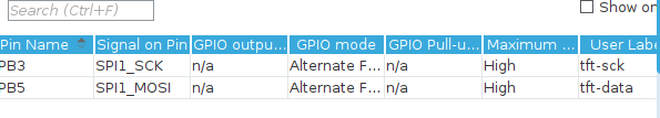

i had high setting for TFT spi on all lines:
0693W00000WJ5XQQA1.pngabout port speed: basically connecting small/more../big mosfets to the output stage -> changes swichting speed, but always depending on load (xx pF) .
