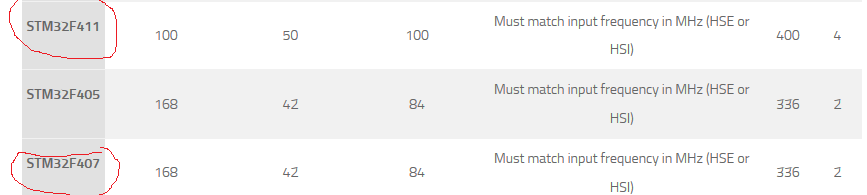

We have an application already running properly on STM32F411 which runs at 100mhz.
When running it on STM32F405 which runs at 168mhz, there are issues e.g., COM port connection to PC etc.
Seems this is the difference between 100mhz and 168mhz.
See https://stm32f4-discovery.net/2015/01/properly-set-clock-speed-stm32f4xx-devices/
Any pointers and advice on what should be tuned and how would be much appreciated.
(please note... It's the first time I'm doing such tweaks related to clock speed...)
thanks!

Tell us how you ported your code as it is today. Maybe first step would be to run on the new mcu with 100 MHz then once working, cranck up to 168 MHz.
If using USB or Ethernet may require specifics. Check the clock tree difference, RCC, peripherals getting having different generations, interrupt vector table differences.

‎2019-09-15 6:05 AM
As it's not an STM32L4 with MSI, I guess your core frequency must be a multiple of the USB needed 48MHz, so try 144 MHz.
‎2019-09-15 6:58 AM
2 * 168 / 7 = 48 and it's possible to set that. ;)
