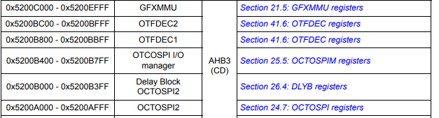

However, I don't understand exactly what is missing for OctoSPI and else than virtual memory for GFXMMU. In the table "Register boundary addresses", we have already the following:
0693W00000DqTOJQA3.pngPlease provide some more details on this regard.
-Amel
Hi, @Amel NASRI​
So those are the AHB peripheral addresses which are used for configuring the devices, but those have memory mapped functionality.
For example, if you look at the OCTOSPI block diagram (Fig 135, page 867) you see it has 2 ports. The AHB port listed in that table you've shown, and an AXI slave port to be a memory mapped device. I could not for the life of me find where that AXI slave port is mapped to. I ended up finding it on line 1964 of the huge hal .h file, and it maps to 0x90000000 (and OSPI2 maps to 0x7000000). the only mentions of these addresses are in the FMC's memory map, Table 133 (page 789) which states it doesn't control those regions. In fact, and maybe this is an error, in fig 107 (page 788) it lists those as FMC memory banks.
Likewise with the GFXMMU. The block diagram (fig 100, page 759) shows some address comes in from the AHB port (this is after an AXI->AHB) to enter its memory map. That diagram shows a 24 bit address. So the GFXMMU is accessed with a 32 bit address sent to the AXI->AHB (fig 2, page 107, bottom right), which strips off the MSByte, and passes it to the table as shown in figure 102 (page 761). and I'm really glad it shows the offsets into that 24-bit address space, but that doesn't help at all. I want to find out when it says 0x00_0000 in the GFXMMU's memory mapped space, what is that in the AXI address space? I could not find that. Where is that? That's on line 2295 of the huge HAL file, defines as 0x2500_0000. So presumably 0x2500_0000(axi)-> 0x00_0000(mmu). 0x250/0x2500 aren't strings in the reference manual, and other variations (2500, 0x25, etc) are not about the GFXMMU and even if one of them is, it would be one of hundreds of results. 0x25 has a result in the I2C section.
