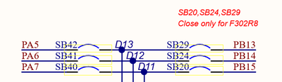

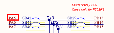

I have tried following the LED on step by step, but for my board. In this instance, the LED I am flashing is LD2 on my board which is connected to pin D13, based on the schematic below (which I obtained from https://www.st.com/en/evaluation-tools/nucleo-f411re.html#cad-resources)

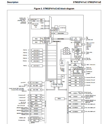

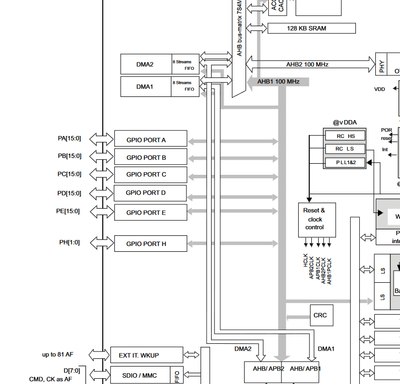

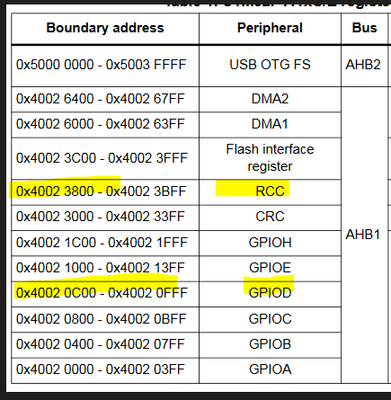

I have used the AHB1 clock channel peripherals as dictated by the architecture in the datasheet of my boards chip.
System architecture up close
Full View

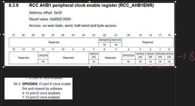

Now, onto its reference manual (RM0383) I use the following Addresses
Boundary addresses used for RCC and GPIOD
Based on this data, my clock enable register has been set as 0x4002 3800 + 0x30 ==> 4002 3830
To enable the peripheral for Port D the value 0x08 was written through an OR shift (see final code)

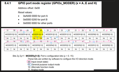

With this data, my register of initialising port D is 0x4002 0C00 + 0x0 ==> 0x40020C00. Pin 13 was highlighted
To clear the register for the 26th and 27th position the value 0xF3FFFFFF was calculated to AND shift, and then set up with calculated hex value of 0x04000000 with the OR shift (see final code)

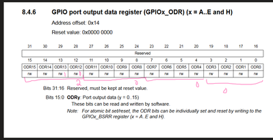

The output register determined to be was 0x4002 0C00 + 0x14 ==> 0x4002 0C14
The final output value 0x2000 based on Pin 13 was masked on the output register with an OR operation (see final code)

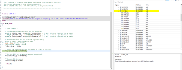

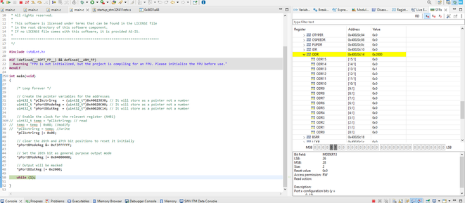

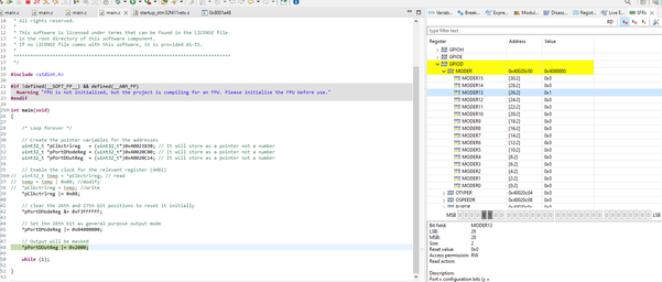

No lights! and I can confirm my LED wasnt busted, as I used an old default LED dimming code which works
I went to debug to monitor the registers to make sure it was working too, and bridged the CN5 to see if it helped but no avail!
waclawek.jan
I've pulled a Nucleo411 from the stash of STM32 boards I have, copypasted your code, compiled, loaded, no LED.
But, observing registers, GPIOD_MODER register is zero. What gives?
I always compile with optimization, and your definitions don't define registers as volatile, so the compiler felt free - and rightly so - to reorganize the code and also omit some of the writes. This, together with poor readability, highlight the fact that not using symbols from the CMSIS-mandated device header is a bad idea.
Regardless, the root problem is elsewhere, and it is, surprisingly, in Arduino... the LED is *not* on pin PD13, but on the pin which is in Arduino world (hence the Arduino header used on Nucleo) called as D13, i.e. 13th Digital pin.
It is PA5.

Thanks Jan! Yes turns out it was the wrong pin:face_with_tears_of_joy: its a very bare metal C programming (so no ST libraries), just standard C ones :) shouldve mentioned that.
