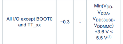

i am using PC2,PC3 and PA2 pins which are FT_xxx Pins (Five volt tolerant pin) for that in Table 20:Absolute maximum rating they said that max voltage for this pins will be Min(VDD, VDDA,VDD33USB, VBAT) + 4.0 and as for ADC the supply is VDDA, so the min of VDDA in Table 23: General Operating conditions will be 1.62 V so as per Absolute maximum rating table it will be (1.62 V+ 4.0 V= 5.62 V) is this correct ? or i am missing something ?

If you select "analog" function on a pin, max. VDDA is the max. value for this pin then.
(You switching the pin multiplexer from digital to analog and so only analog min. or max. values apply.)
So for ADC the max. usable input is Vin = VREF , the maximum without destruction is up to 3.6 V .
(Any "5V-tolerant" is only for pin in digital input mode, so it will survive (digital) signals up to 5.5 V .)

No.  3.6V is max. analog Vin at 3v3 VDDA.
