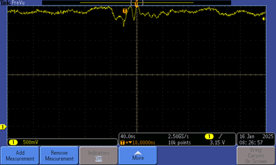

I have used a scope to look at the VDD / 3V3 rail. It is very difficult to trigger on this but I think I can see a small and brief voltage dip to about 2.940V when I try the Full Chip erase from STM32CubeProgrammer. Is this enough to cause an issue?

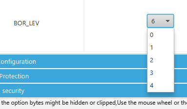

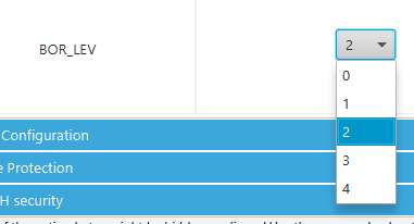

BOR_LEV for the failing unit was 4 (2.8V). I changed BOR_LEV to 2 (2.2V) and repeated the test and still got ”Error: Mass erase operation failed! Please verify flash protection”.
I my first post I did ask about BOR_LEV. BOR_LEV is 6 in STM32CubeProgrammer when connected to my good unit. The failing unit BOR_LEV = 4. What does BOR_LEV = 6 mean (it is not documented)? I cannot change my failing unit to BOR_LEV=6 as STM32CubeProgrammer does not give me that option.
Here is a screen shots for the working unit.
Here is a screenshot for the failing unit after I made the change I describe above.
