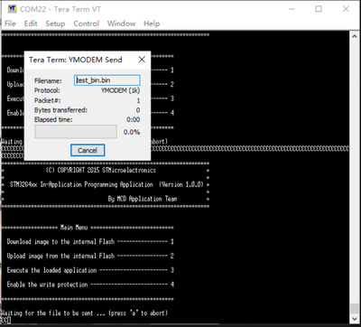

Now I am designing a IAP program for STM32G474VET6 according to the AN4657 referred to STM32L476G_EVAL. and I used VScode +CMake tools.
I have modified the flash_if.h because of the diffrence between STM32G474VET6 and STM32L476G as below

the issue I met is when I used Tera Term to transfer an APP bin file, the transfer stopped and the result is time_out as below
I am sure that the UART is OK because I can receive the menu strings and send 1 for choose download.

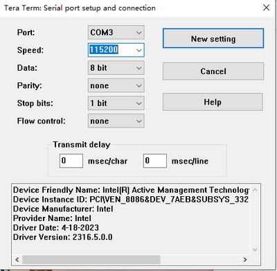

How is your TT COM config?

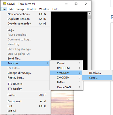

3. TT COM config as the AN4657 required, as below
send bin file as below
is something wrong?
if my TT config something wrong, how can I get the menu strings and I sent 1 for choosing download?
please give some advice.
