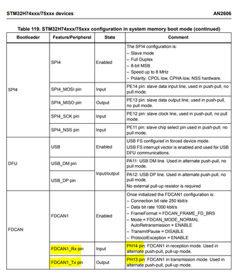

FDCAN bootloader on UFBGA169 STM32H743AI
App note AN2606 says I should use FDCAN1_Rx pin PH14 (similary Tx pin) to be able to use FDCAN bootloader but selected package UFBGA169 doesn't have such pins.
Can I use default FDCAN Pins to work with bootloader?

Hello @DrDro ,
A similar question is already asked here.
For STM32H743, you can activate the FDCAN bootloader with only by PH13/PH14 pins.

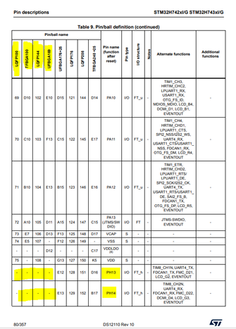

What does that mean "you can activate the FDCAN bootloader with only by PH13/PH14 pins."?
Those pins dont exist right?

As mentioned in AN2606, for STM32H74, the FDCAN bootloader pins are PH13 and PH14. So, if the PH13 and PH14 pins are not available in some packages, the FDCAN bootloader is not supported.
The LQFP100, TFBGA100, LQFP144, and UFBGA169 STM32H743 packages do not have PH13 and PH14 pins, so the FDCAN bootloader is not supported.

@KDJEM.1 wrote:
if the PH13 and PH14 pins are not available in such packages, the FDCAN bootloader is not supported.
That's really not very clear at all!
See:
https://community.st.com/t5/stm32-mcus-products/fdcan-rom-bootloader-pins-for-stm32h743zi/td-p/762439
And:
https://community.st.com/t5/stm32-mcus-embedded-software/fdcan-bootloader-for-stm32h750vb/td-p/95844
The document needs to be updated to make this clearer.
KDJEM.1
Jan 16, 2025 1:26 PM UTC
Thank you @Andrew Neil and @Javier1 for reporting your feedback about the AN2606 application note. I reported internally your suggestion to add a note “Where these pins are available” to clarify the behavior this discussion FDCAN ROM bootloader pins for stm32H743ZI - STMicroelectronics Community.
Note that, also I reported internally the datasheet typo for correction.
