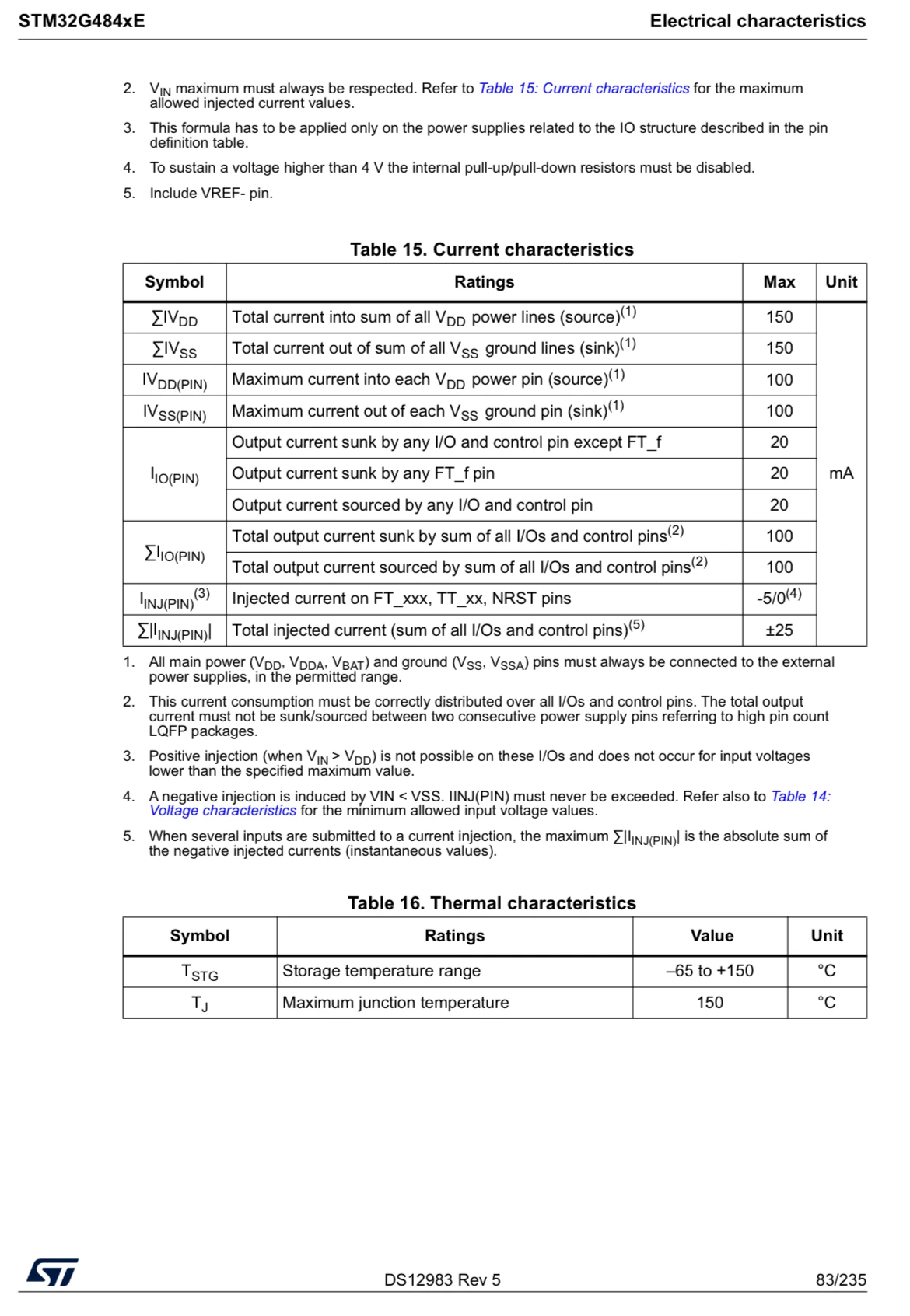

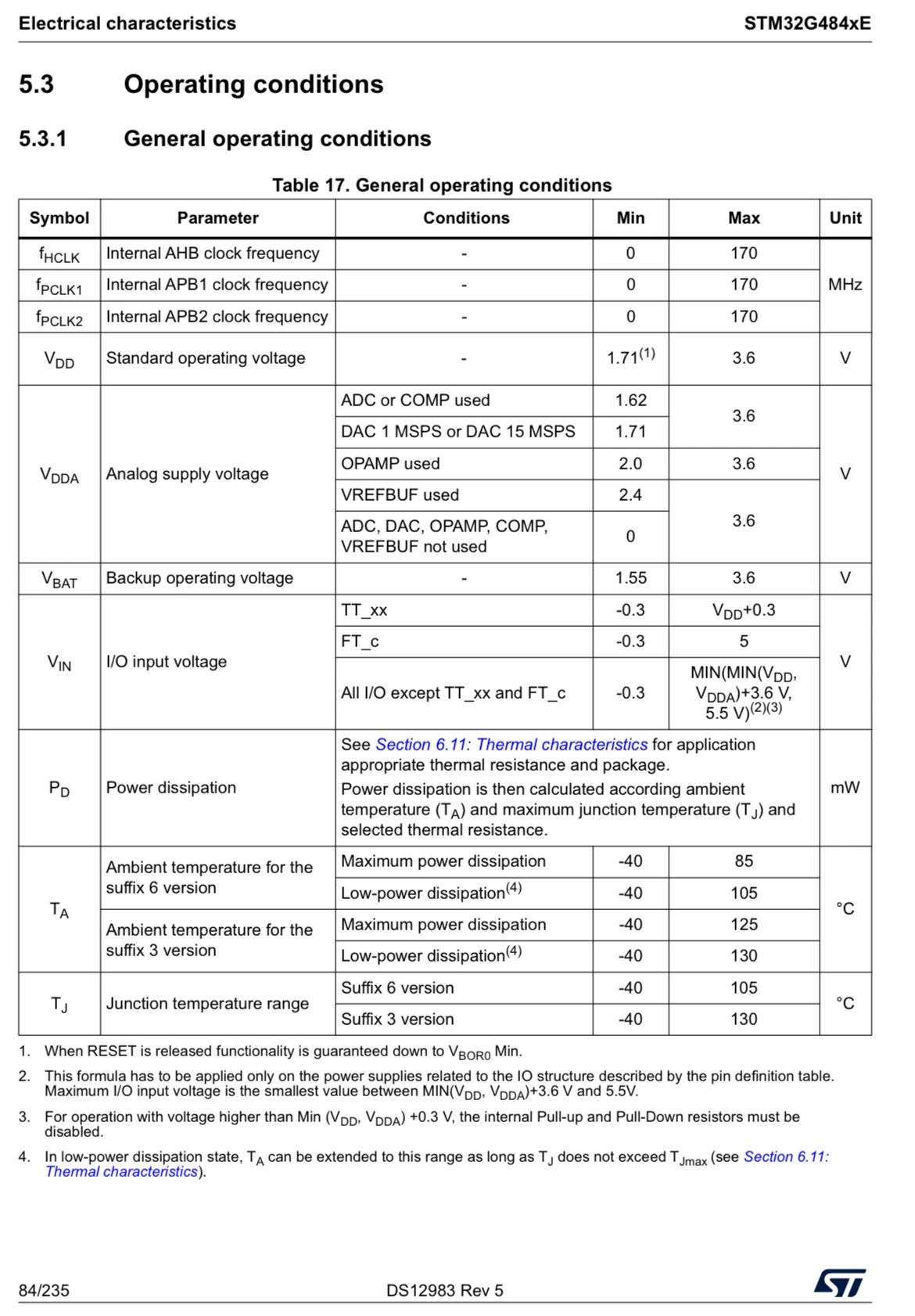

Are there any guides or tips on making an STM32 MCU last in a high temperature (~150°C) environment? Specific voltage or clock speed tweaks?
The MCU would sleep most of the time, but now and then take and store some measurements.
Would certain families be better (for example because of different semiconductor nodes)? We're looking at the G4 and L4 MCUs (G4 for the embedded OPAMPs) but the application would work with pretty much any part number.

Indeed we have few customers going beyond our products specification from time to time and may work properly . They rely on their own application qualification at the required environment.  You can see that our STM32G4 can sustain up to 150 degree in AMR ( Absolute Maximum Rating) it is a good choice for your application.
