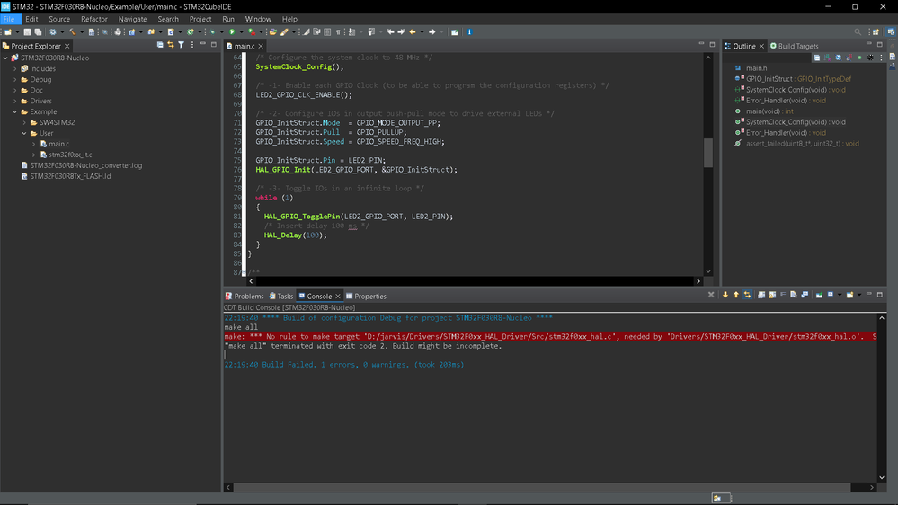

Hello everyone,
​I use GPIO example project (from repository of ST) and open it by STM32 cube IDE. then when I built it give error:
make all
make: *** No rule to make target ...
How to fix this error?

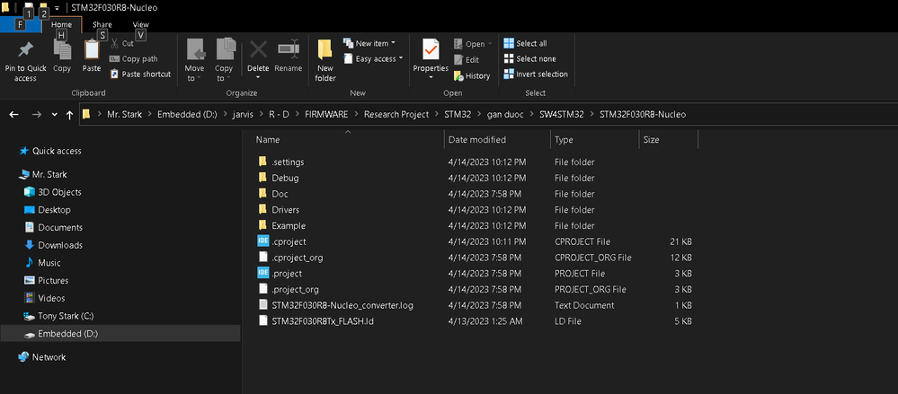

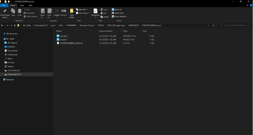

    here are the steps i took:
    1. copy GPIO example project ​ in repository of ST from ​(C:) disk
    2. open folder GPIO project > SW4STM32 > ".project" and cube ide opened, then i built it. it error "no such file or directory" and when I include path, it error "make: *** No rule to make target ..." as name's topic.

    Do not copy the example, but open the project in the repository tree. The projects use relative paths to the Drivers folder.

    Apr 14, 2023 8:27 PM UTC
    Wow! It done. Thank you very so much! very impressive! Bravo!​
