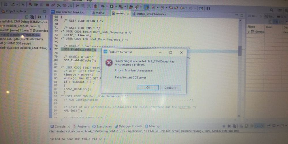

Hi, I'm trying to debug and run simple assembly code in Nucleo-H745ZI-Q board .The IDE successfully builds the program without throwing any errors, However when I try to debug the program CM4 throws the following error:
Error in Final Launch Sequence
Failed to start GDB server

Hello @Harsh_18 and welcome to the Community :),
I recommend you to take a look to Getting started with projects based on dual-core STM32H7 microcontrollers
in STM32CubeIDE application note and precisely 3 Debugging chapter.
This chapter highlights some of the points to bear in mind while debugging a device in the STM32H7 Series.
Thank you.
Kaouthar
RhSilicon
Lead
August 7, 2023
I don't know if it can help in your case, but I found these videos about advanced debugging:
https://youtube.com/playlist?list=PLnMKNibPkDnEDEsV7IBXNvg7oNn3MfRd6
