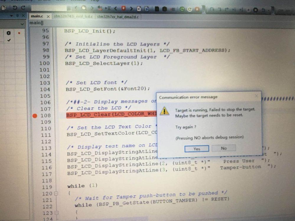

I'm using stm32h753-eval, when I use LTDC demo, if i use BSP_LCD_Clear(LCD_COLOR_WHITE) , the program will crash. I need help, thank you very much

I build this project with IAR.
I debug this demo and set a breakpoint at "BSP_LCD_Clear(LCD_COLOR_WHITE);",

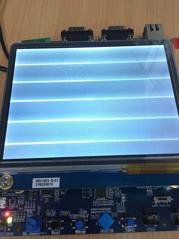

When the program executes to a breakpoint , it's ok , then the program cotinue to go , the LCD
will show like the following picture,

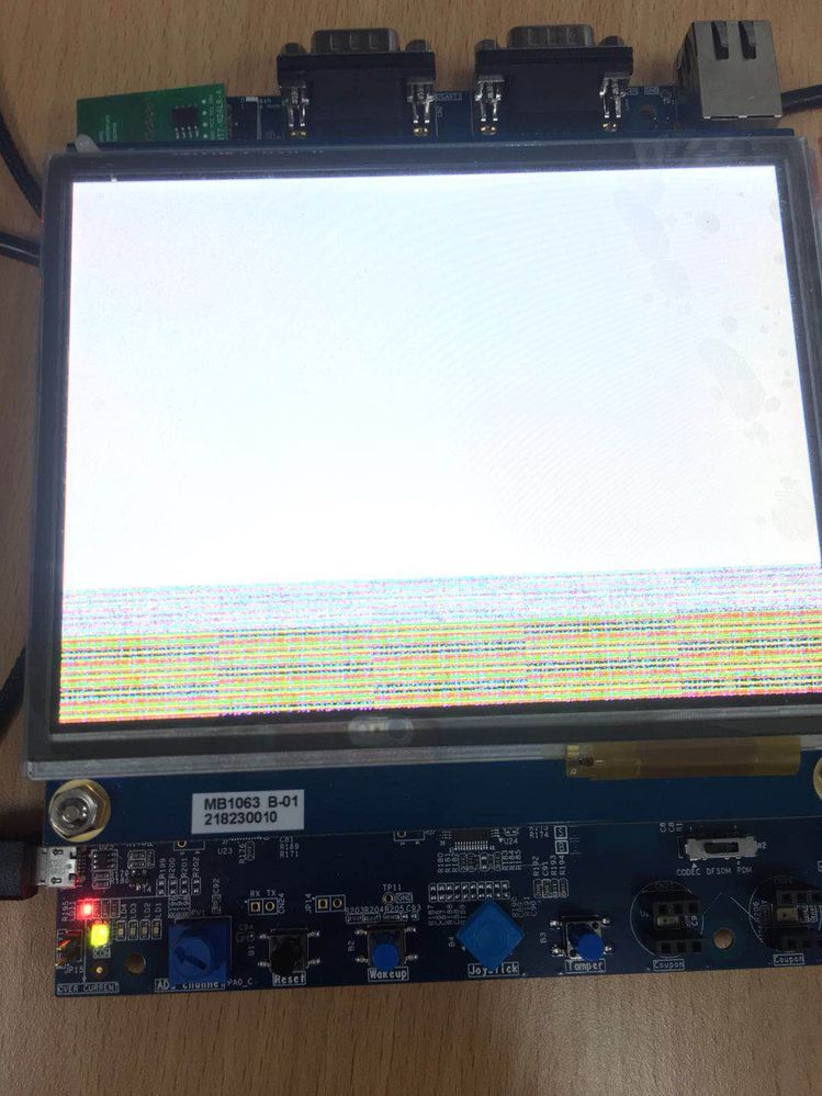

‎2018-12-17 9:31 PM
The screen flashed and IAR will crash.
‎2018-12-17 9:35 PM
I use SDK(STM32Cube_FW_H7_V1.3.0) and STM32H753I-EVAL board.
