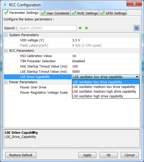

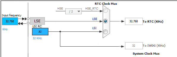

Posted on October 04, 2017 at 17:11
Hello STM32CubeMX is now fixed.
You can check it out by :
1. Enabling LSE in crystal mode
2. Enabling RTC peripheral
3. On the clock tree select LSE as RTC clock :
4. Open from the configuration tab, the RCC configuration window and check LSE drive option:
5. generate code and find proper sequence of initialization:

Mike Forster
Posted on February 01, 2018 at 13:53
kermeci is correct that the so called fix to CubeMX doesn't work. As he says the code generated writes to the RCC_BDCR register while it is in Read only mode.
Mike
