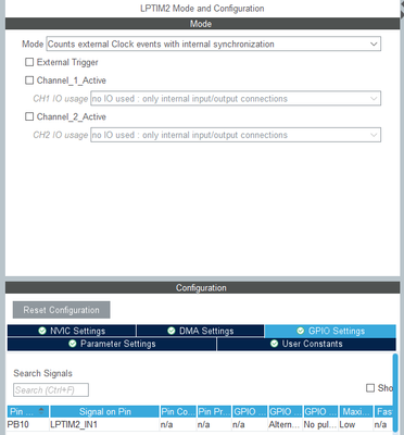

On NUCLEO-H563ZI board I put 3KHz square wave on LPTIM2_ETR (PC4). I want LPTIM2 to continuously count. However the count never increases. LPTIM2 setup...

 Following HAL_LPTIM_Counter_Start() CR = 0x5 and and CFGR = 0x800001. But CNT is zero. Same result if I use alternate ETR PE0.
What is missing?
Sarra,
Thank you! Using LPTIM_INPUT1SOURCE_GPIO works. LPTIM2 configured with STM32CubeIDE as follows...

No, not a solution yet! Any way undo the accept?
The initialization already sets clock source to LPTIM_COUNTERSOURCE_EXTERNAL. Not clear to me why I need input sources at all. At one time LPTIM1, LPTIM2, and LPTIM6 worked fine. Then something unknown changed and none of the LPTIMs count.
waclawek.jan
Read out and check/post content of LPTIM and relevant GPIO registers.
Sarra,
