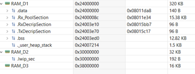

Firstly I apologize for the length here.....In short I am just trying to get a ping tx and rx from a nucleo....Most is sharing of what I have done / setup....Hoping you can enlighten me to something I may have missed??
I received my nucleo board NUCLEO-H723ZG.  I followed the following video instructions:
https://www.youtube.com/watch?v=8r8w6mgSn1A&list=PLfIJKC1ud8ggZKVtytWAlOS63vifF5iJC&index=1
as best as I could given the RMII vs his MII as well as sizes because the 723 is smaller and the code compiled and I do not get fault errors when running.  However I do get Destination Host Unreachable constantly.

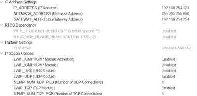

My CubeMX ethernet settings are:

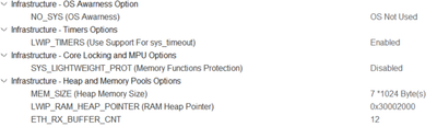

LWIP settings:
The sizes keep everything within SRAM1 per the datasheet (0x30000000 - 0x30003FFF)....
I altered the xxx_FLASH.Id file with :
  .lwip_sec (NOLOAD) :
    . = ABSOLUTE(0x30000000);
    *(.RxDecripSection)
    . = ABSOLUTE(0x30000060);
    *(.TxDecripSection)
    . = ABSOLUTE(0x300000C0);
    *(.RxArraySection)
  } >RAM_D2
and finally the ethernetif.c file to :
ETH_DMADescTypeDef DMARxDscrTab[ETH_RX_DESC_CNT] __attribute__((section(".RxDecripSection"))); /* Ethernet Rx DMA Descriptors */
ETH_DMADescTypeDef DMATxDscrTab[ETH_TX_DESC_CNT] __attribute__((section(".TxDecripSection")));   /* Ethernet Tx DMA Descriptors */
#endif
#if defined ( __ICCARM__ ) /*!< IAR Compiler */
#pragma location = 0x30000100
extern u8_t memp_memory_RX_POOL_base[];
#elif defined ( __CC_ARM ) /* MDK ARM Compiler */
__attribute__((section(".Rx_PoolSection"))) extern u8_t memp_memory_RX_POOL_base[];
#elif defined ( __GNUC__ ) /* GNU */
#endif
/* USER CODE BEGIN 2 */
RxBuff_t rxBuff[ETH_RX_BUFFER_SIZE] __attribute__((section(".RxArraySection")));
/* USER CODE END 2 */
so that the sections exist.
When I run I don't crash or hang up but I do notice that in the Build Analyzer section I do NOT get the .RxAarraySection to show up.  And here is the confusing part...Notice RAM_D1 seems to be showing the RxDecriptSection, etc at 0x24000000 space vs RAM_D2....From your experience can you shed any light on this?
Thanks
Steve

Alone seeing this "RxDecriptSection" from Cube gives me the creeps... :D But I'm a little oversensitive with things like that.
Anyway,
0) RMII should be no problem, setup is handled well be Cube.
1) It's important that the descriptors are in SRAM1, the TX / RX buffers can also be in AXI SRAM - where you actually placed the lwip pool (used for lwip packet buffers "pbuf"), which is okay.
Check RM0468, 2 Memory and bus architecture, it starts with a table which bus master (incl. ETH DMA) can access which RAM or peripheral.
2) rxBuff: the declaration looks good, so is that actually used somewhere? Should be... but I don't use the ETH HAL driver.
I would debug with a breakpoint somewhere in "ethernetif.c" where ethernet data is received and given to lwip.
As I said, it will be lots of work, with lots of frustration - but the H7 can do it!
