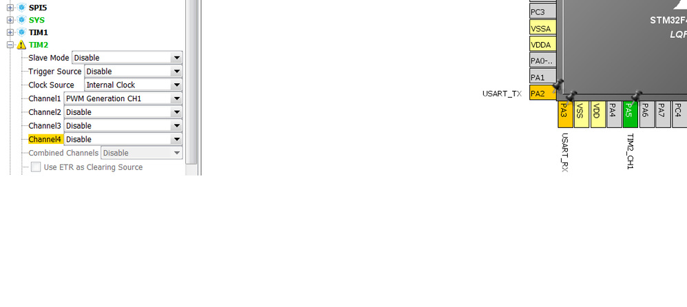

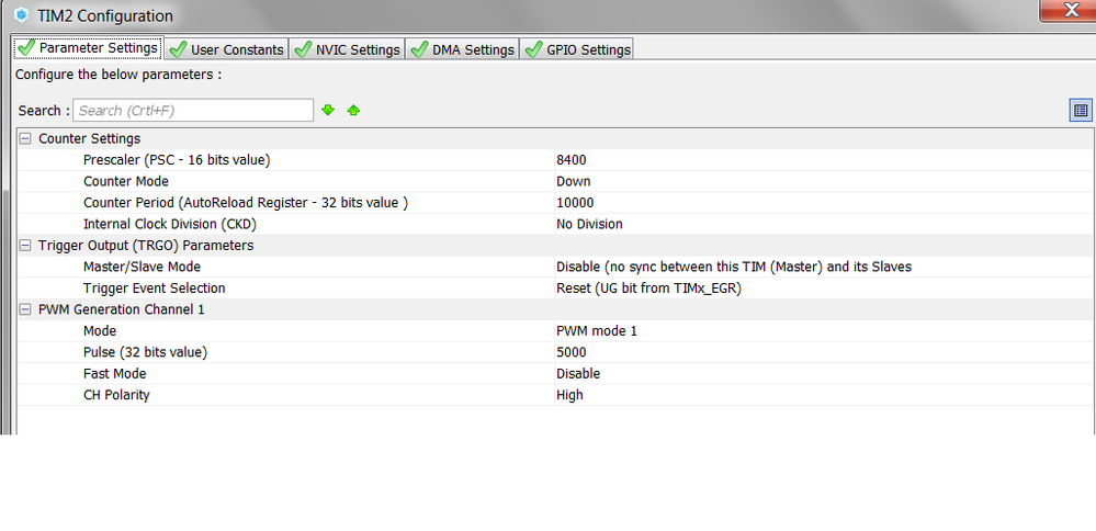

Posted on June 20, 2017 at 22:35
Just took nucleo-F411, 84MHz clock, default Cube project:.
1. Enable Timer2 (in my case this one could drive the onboard LED connected to PA5)
2. Configure Timer 2
Since I have 84MHz clock I used 8400 as prescaler, Period of 10000, 5000 for pulse.
3. Generate the code and add line to start the Timer:
It works fine with the latest Cube 4.21.0
Posted on June 20, 2017 at 22:44
Here you have project file:
