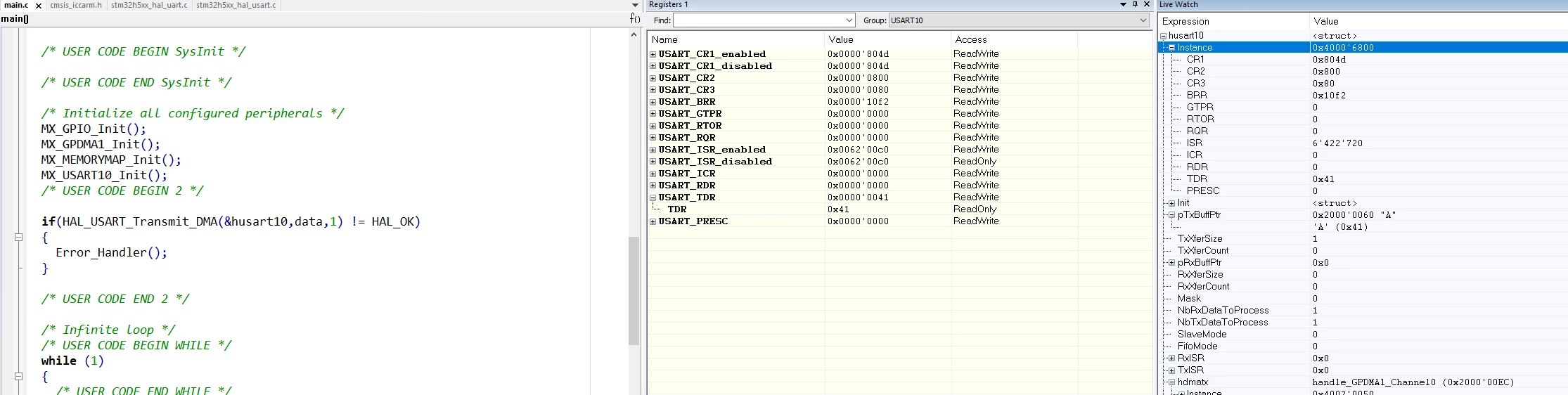

I'm using an STM32H563 and the STM32CubMX for initialisation. I'm trying to use the USART in DMA mode and having trouble with the Tx DMA.
I use:
HAL_UARTEx_ReceiveToIdle_DMA(&huart10, (uint8_t *) uart10RxDMABuffer, UART10_RX_BUFFER_SIZE);
for the receive and get characters into my buffer and an interrupt after IDLE. In the interrupt I start a timer (for a delay). I get the timer interrupt then attempt:
HAL_UART_Transmit_DMA(&huart10, (uint8_t*)uart10TxDMABuffer, uart10TxSize);
This completes with a HAL_OK. But I don't get any characters from the UART and I don't get a transfer complete interrupt.
The DMA of the H5 (M33) is completely different to previous series. Are there any other steps I need to take that are particular to the H5 DMA controller?
Edit:
I've also noticed that if I comment the HAL_UART_Transmit_DMA I can receive multiple strings from the UART Rx and each time get an interrupt on the IDLE. Once I've attempted to call the transmit DMA the receive side stops working.

Thank you for your suggestions. I made a separate project with just the UART initialisation and test code. Thinking this would be cleaner and more concise to upload as an non-working example.
It works fine. In that I can receive, then send using polled or DMA, and I'm still able to receive again.
It must be something else in my bigger project that is interfering. I'll start adding blocks back in until it fails again.

specifically regarding UART, DMA and H5 series, please check the following ERRATA:
https://www.st.com/resource/en/errata_sheet/es0621-stm32h523xx-and-stm32h533xx-device-errata-stmicroelectronics.pdf
Basicalliy: "USART does not generate DMA requests after setting/clearing DMAT bit"
A possible workaround is to don't clear this DMAT bit.
So look for any of: ATOMIC_CLEAR_BIT(huart->Instance->CR3, USART_CR3_DMAT);
This is done, among other, in: static void UART_DMATransmitCplt(DMA_HandleTypeDef *hdma)
So my guess is: if you are using UART+DMA and interrupts, I am quite sure that tha function "UART_DMATransmitCplt" is called and the DMA tx won't work anymore for the next transmission.
Maybe you have a chance if you are not using interrupt, but I am not sure.
