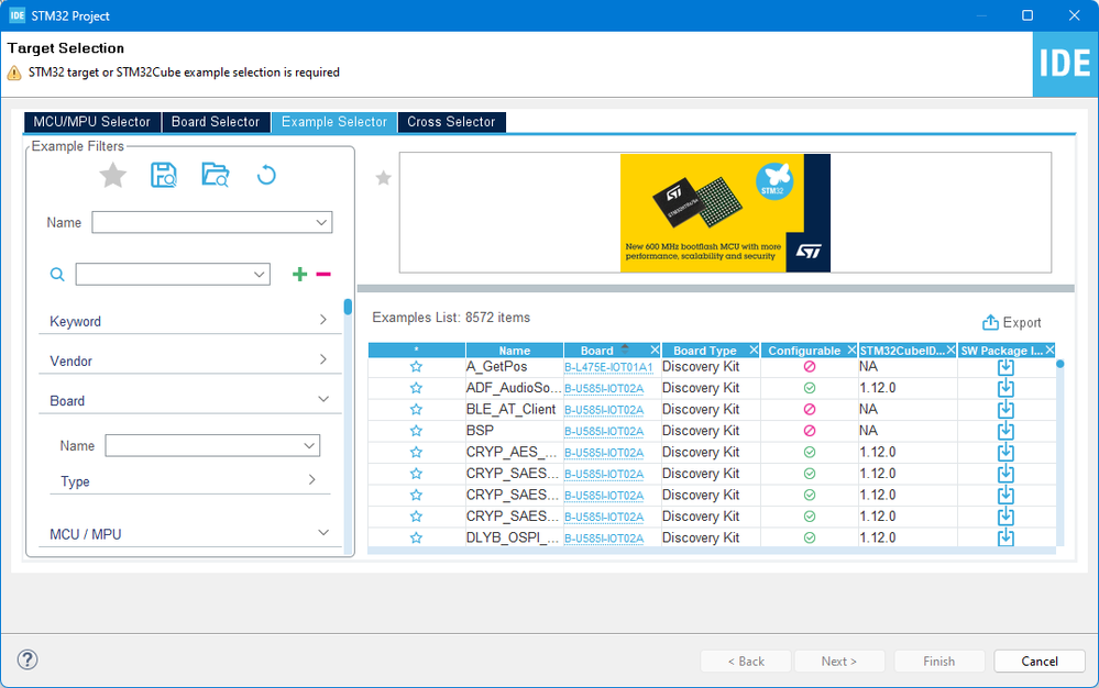

(some) example projects don't use *.ioc file?
FBerg.1
E.g. the FatFs_USBDisk sample does not have a *.ioc file.
Maybe not all example projects use STM32CubeMX?

How can I enable the view "Device Configuration Tool" for that example project?
Or: what's the best way to see the Mikrocontroller resources used by that project?

@Andrew Neil wrote:
Correct - they don't all have a .ioc file.
I think the 'Configurable' column tells you which is which:
AndrewNeil_1-1721148616417.pngfor the ones which do have a .ioc file;
AndrewNeil_2-1721148655038.pngfor the ones which don't.
PS:
This, of course, doesn't stop you from re-configuring the project - it just means that you have to do it directly in code, rather than though the CubeMX GUI.
In most cases, the so-called non-configurable (sic) ones will have a Board Support Package (BSP) to abstract the hardware details and, thus, facilitate re-configuration.

Andrew Neil
Some just have C initialisation code for the clocks, peripherals, etc - see here.
You can't.
Just have to browse the code to see what's used.
If the example in question is for an ST board, then MXCube should have awareness of that board ...
