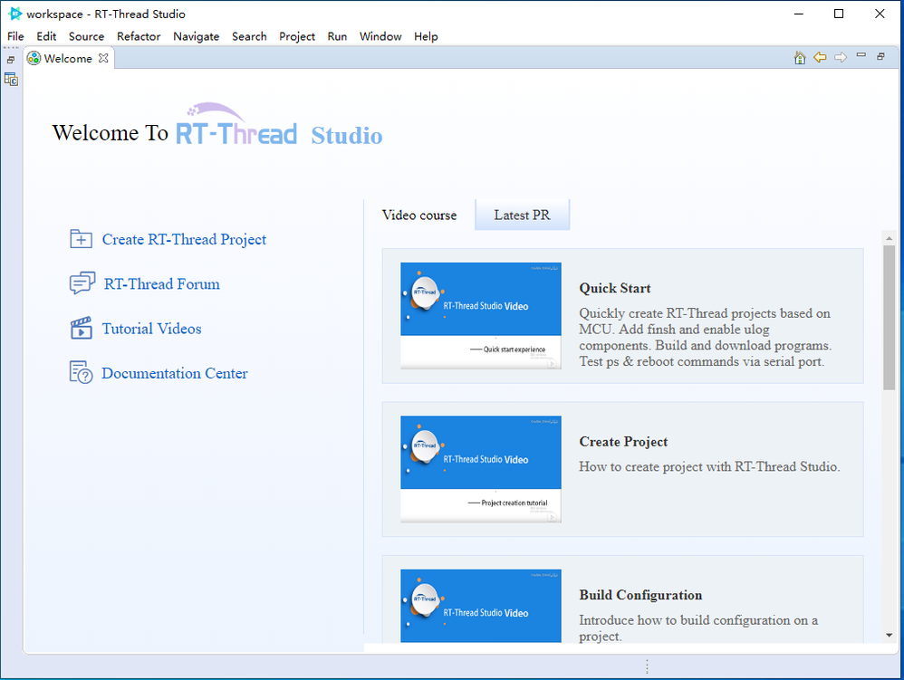

After successful login, you can see the welcome page of the software

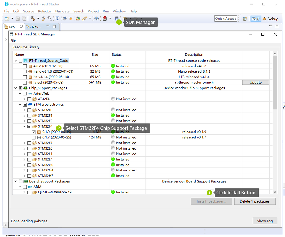

Step 2 Install PlatformIO Package
Close the welcome page, you can see the project manager and C/C++ development view, here we install some necessary resource packages to support the development of STM32 F411, the installation steps:
  1. Click the SDK manager icon
  2. Select PlatformIO 5.0.3.12 version
  3. Click the Install Package button to execute the installation

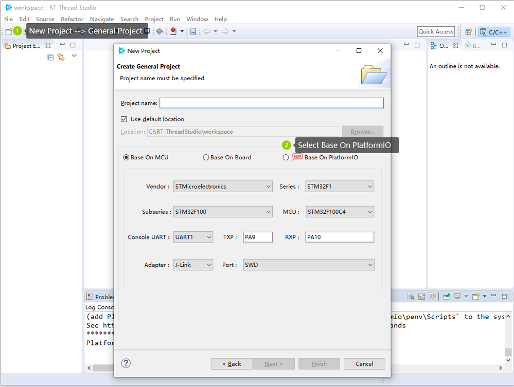

Step 0 Create stm32f411re Arduino project
Click the Create Project button in the upper left corner of the IDE to create a new project. Here we choose to create General Project and choose to use the PlatformIO platform. The steps are as follows:
  • Create General Project
  • Select Base On PlatformIO
  • Search f411re
  • Select Nucleo_f411re board and Arduino framework

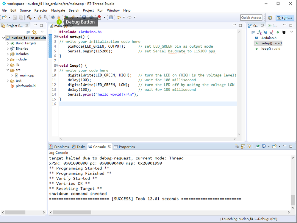

Step 1 Add LED Blink Code
The created nucleo_stm32f411re_arduino project is an empty project. Add the blinking code of the LED in src/main.cpp to realize the blinking of the LED.
#include <Arduino.h>
void setup() {
// write your initialization code here
    pinMode(LED_GREEN, OUTPUT);      // set LED_GREEN pin as output mode
    Serial.begin(115200);            // set Serial baudrate to 115200 bps
void loop() {
// write your code here
    digitalWrite(LED_GREEN, HIGH);   // turn the LED on (HIGH is the voltage level)
    delay(100);                      // wait for 100 millisecond
    digitalWrite(LED_GREEN, LOW);    // turn the LED off by making the voltage LOW
    Serial.print("hello world!\r\n");

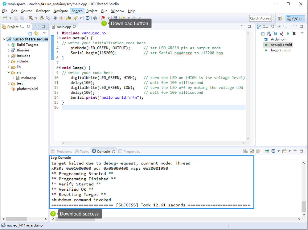

Step 2 Build nucleo_stm32f411re_arduino project
After adding the LED blinking code in main.cpp and saving it, click the small hammer build icon to compile the project
Step 3 Download

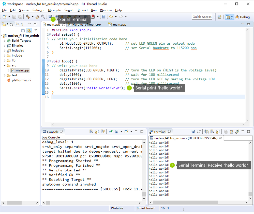

Link the Mini USB cable to the development board, click the download button on the toolbar, and then the program can be downloaded
After the download is complete, you can see that the green LED starts to blink, the IDE integrates a serial port terminal, open the serial port terminal, connect to the serial port, you can see the "hello world" message

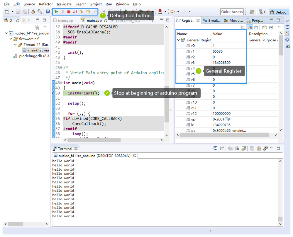

Step 4 Debug
RT-Thread Studio supports online simulation. Click the debug button on the toolbar to enter the debugging interface. The debugging simulation supports single-step, suspend and other debugging operations
