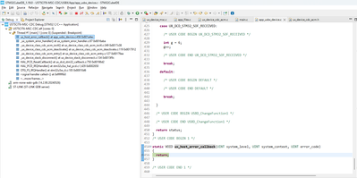

After doing more debugging, the error seems to be triggered by the OTG_FS_IRQHandler, which then climbs up the stack triggering a reset callback.  Am I correct in my thinking that maybe the CDC is trying to write out the text when the stack is disconnected thus throwing the error?  Or is it something else that is causing the issue.  Below is a screenshot of the call stack when the error occurs.
Any insight would be greatly appreciated.
Kindest regards
