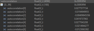

Now that's all great, but I can not seem to get the same functionality as this C code when working on the STM32 with CMSIS and I feel like I've tried everything, so I am not certian that the ifft/fft functions in CMSIS are exactly the same as FFTW or python. Here is my (not working attempt):
void autocorrelate(float32_t* x, uint32_t N, float32_t* autocorrelation) {
    float32_t* p_fft_input;
    float32_t* p_fft_output;
    arm_rfft_fast_instance_f32 fftInstance;
    // Allocate memory for the input and output arrays
    p_fft_input = (float32_t *)malloc(sizeof(float32_t) * N * 2);  // FFT input is 2x for complex numbers?
    p_fft_output = (float32_t *)malloc(sizeof(float32_t) * N * 2); // FFT output is also 2x for complex numbers?
    // Initialize the FFT instance
    arm_rfft_fast_init_f32(&fftInstance, N);
    // Zero-pad the input array and copy the real signal into the input array
    for (uint32_t i = 0; i < N; ++i) {
        p_fft_input[i * 2] = x[i];     // Real part
        p_fft_input[i * 2 + 1] = 0.0f; // Imaginary part, which is zero
    // Calculate the FFT
    arm_rfft_fast_f32(&fftInstance, p_fft_input, p_fft_output, 0);
    // Calculate the power spectrum (magnitude squared)
        arm_cmplx_mag_squared_f32(&p_fft_output[i * 2], &p_fft_output[i], 1);
    // Inverse FFT to get autocorrelation
    arm_rfft_fast_f32(&fftInstance, p_fft_output, autocorrelation, 1);
    // Normalize
        autocorrelation[i] /= (float32_t)N;
    free(p_fft_input);
    free(p_fft_output);
I tried to implement sort of what FFTW is doing, but I am not sure if that is right. But regardless, what I should get for the autocorrelation is
Autocorrelation:
767.814944
761.705596
743.474793
713.412709
671.997833
I instead get very off numbers:
I am very stuck on this, so if anyone has any sort of insight as to why the cmsis library is not producing similar results I would appreciate. I am thinking I might have to do more conditioning to the input to the ifft due to some differences, but what that is I am not sure. I pretty much only have a basic understanding of how these functions work.
