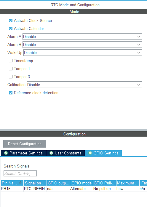

I'm having some trouble with trying to correct the RTC drift on a STM32F439NIHx. I've enabled the REF_IN and provided a 50Hz signal on the pin, but the RTC still drifts by around 1s per day.
I've also tested that the 50Hz signal is correctly received by changing the pin to an external interrupt and correctly generated 50 interrupts per seconds.
Am I missing something or doing something wrong in the setup:

‎2023-04-24 11:10 PM
I think we'd already tested with GPIO_InitStruct.Mode = GPIO_MODE_AF_PP; before and the drift was the same.
for GPIO_InitStruct.Alternate = GPIO_AF0_RTC_50Hz; it doesn't change anything since its default value is already 0.
I'll restart a test with GPIO_MODE_AF_PP to be sure, but I don't think that's the issue.
‎2023-04-25 2:18 AM - edited ‎2023-11-20 7:20 AM
i set refclk in Cube->
then cube gen ->
/** Enable the reference Clock input
if (HAL_RTCEx_SetRefClock(&hrtc) != HAL_OK)
Error_Handler();
/* USER CODE BEGIN RTC_Init 2 */
-> and no GPIO_PIN_15 init in main ... !
‎2023-04-25 2:54 AM
I don't use Cube, so I'm not sure how the code generation works, but the GPIO init is probably somewhere. Still, as waclawek.jan said, the GPIO mode I had was INPUT while your screenshot shows it in Alternate, so I'm redoing the test with it in GPIO_MODE_AF_PP. (I think we'd tried this config before, but better to be sure)

‎2023-04-25 4:08 AM
I checked and the code I have is doing mostly the same things, with the difference of GPIO_InitStruct.Mode = GPIO_MODE_INPUT; instead of GPIO_InitStruct.Mode = GPIO_MODE_AF_PP; The test for this correction is running, but it takes 1-2 days to be sure whether it changes anything.
For GPIO_InitStruct.Alternate = GPIO_AF0_RTC_50Hz; I don't have it, but this just sets the value to 0, which is its default value when the structure is initialized, so missing it shouldn't have an effect.

‎2023-04-26 10:55 PM
It was indeed the GPIO_InitStruct.Mode = GPIO_MODE_INPUT; that was wrong.
The setup is running now for two days with GPIO_InitStruct.Mode = GPIO_MODE_AF_PP; and the time hasn't drifted.
