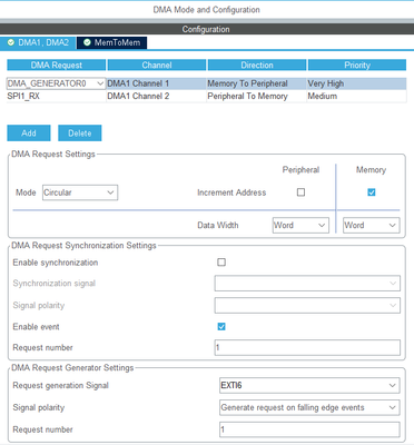

- DMA1 Channel 1 is configured as DMA_GENERATOR0 to handle the DRDY falling edge, which triggers a DMA request. This request sets the Chip Select (CS) low by writing to the GPIOX_BRR register and also generates an event.

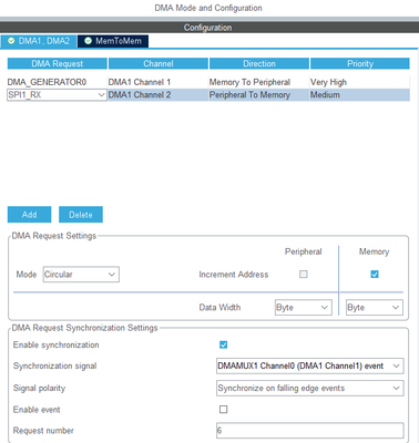

- DMA1 Channel 2 is assigned to SPI1_RX, synchronized with DMAMUX1 Channel 0 event (linked to DMA1 Channel 1) to trigger the SPI1 receive operation, capturing 6 bytes of ADC data.
- SPI1 is configured in full-duplex mode in CubeMX, and once ADC configuration is complete, RX_ONLY mode is enabled to set SPI1 as a receive-only master, generating a continuous SPI clock.
- On each DRDY falling edge, DMA1 Channel 1 triggers the Chip Select, and SPI1 then receives ADC data. In the SPI_RxCpltCallback(), I reset the RX_ONLY bit to stop the SCK and set the CS pin high again and In the EXTI_Callback() I set the RX_ONLY bit to start the SCK for next cycle.

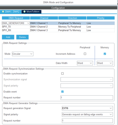

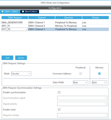

2024-11-17 9:31 PM
I resolved the issue by configuring SPI1 in full-duplex mode and synchronizing only SPI1_TX with DMAMUX CHANNEL0 Event. SPI1_RX was set to circular mode, allowing me to read all ADC channel data (27 bytes) every 125 µs (8 ksps) as per the setup below.
