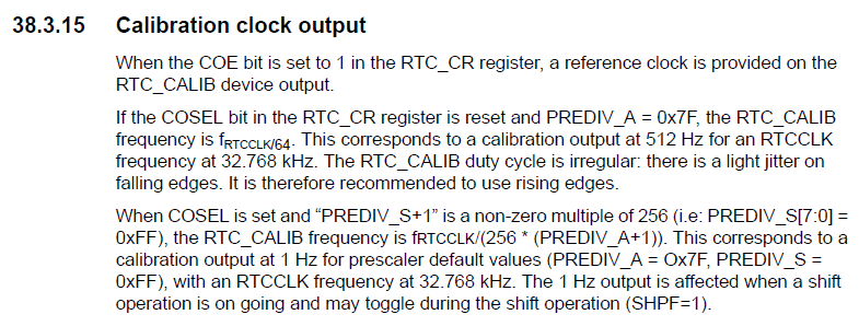

For the second issue, RTC_OUT is not 1 HZ  because  the 1HZ freq taken from   fRTCCLK/(256 * (PREDIV_A+1))  =128
The PREDIV_A=0.
Regards

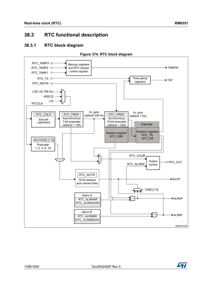

Results observed from RTC_OUT is then consistent, reference manual is confusing because RTC block diagram:
shows ck_spre is connected to RTC_CALIB and0690X00000608ICQAY.png so I expect 1Hz for PREDIV_A: 0 and PREDIV_S: 32767.

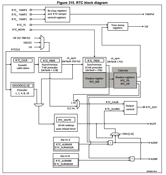

Posted on September 20, 2017 at 12:38
Always get a current version of the RM you are working with:
It correctly depicts the RTC_CALIB to be outputs from the dividers - the ''512Hz'' is obviously a tap from the 6th bit of async divider and the ''1Hz'' is a tap from the 7th bit of the sync divider (ST: the narrative might say so, not just having described behaviour when mägic values are present in the prescaler regiters).
