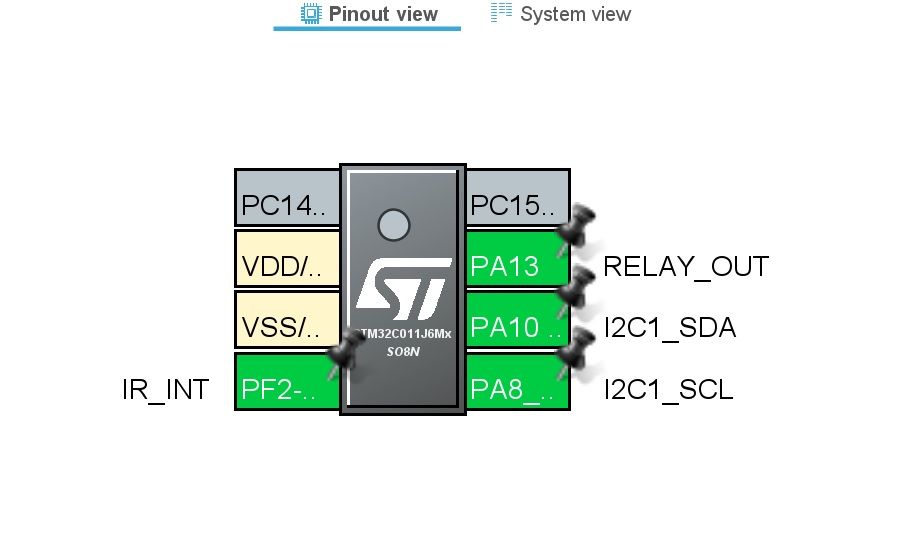

Here,
PF2_NRST pin (Pin Number - 4) is configured as digital input pin.
And PA13 pin (Pin Number- 7) is configured as digital output.
When toggling the pin PA13, getting proper voltage level 3.3 volts and 0 volt. While reading low level on the input pin the controller is pulling down the output pin level from 3.3 volts to 1 volt. Tested in both conditions i.e internal pull up enabled and the disabled. Please check the below lines of code.

2023-06-23 11:16 PM - edited 2023-06-23 11:17 PM
Did you disable NRST pin function in the option bytes?
hth
KnarfB
