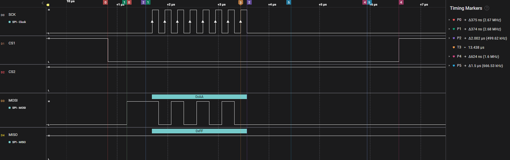

I am familiarizing myself with the SPI controller on a NUCLEO-F303K8 development board using the CMSIS device headers. I have written a program to send and receive a single byte using polling or interrupts. While functionally it appears correct, I am a bit confused on the timing diagrams generated by my logic analyzer.
Overall configuration: System clock is HSI at 8MHz. SPI clock has default prescaler of 2, so 4MHz.
The above is the result for a polling transaction.
Interval 0: SPI enable to CS low, 6 cycles - makes sense
Interval 1: CS low to shift register filled with tx data, 3 cycles (1 CPU cycle to store, 1 SPI cycle to put it on the line?)
Interval 2: Shift register filled with tx data to transaction start, 3 cycles - not sure what happens here
Interval 3: The transaction, 16 CPU/8 SPI cycles - makes sense
Interval 5 (manually added): Reading the shift register and setting CS low - should be 4 cycles (marked it wrong in diagram)
As the SPI is configured with CPOL = CPHA = 0, I would expect RXNE to go high as soon as Marker 4 as the last rx bit is latched, but I suppose there could be more overhead with the FIFO. The left end of Interval 6 is where I would expect the CPU to find RXNE high (a few cycles in a loop), read the shift register, and set CS low, but this does not happen until Interval 5 - around 12 cycles later. Interval 6 is what I'm interested in. I found similar results using interrupts to respond to RXNE.

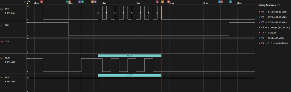

 Above is the interrupt transaction. Similar intervals are highlighted, although Interval 5 and Interval 4 make up the expected Cortex M4 interrupt latency (12 cycles) and reading the shift register/setting CS low, respectively. The interval of interest here is Marker 3 to the left end of Interval 5.
Finally, here is the code.
#include <stdint.h>
#include "stm32f3xx.h"
#include "core_cm4.h"
 * SCK = PA5, MOSI = PB5, MISO = PB4, CS = PB6
 #define GPIO_MODE_OUTPUT 0b01
 #define GPIO_MODE_ALTERNATE 0b10
 #define GPIO_SPEED_HIGH 0b10
 #define GPIO_PULLUP 01
 #define GPIO_SPI_ALTERNATE 5
 * SCK: PA5, push-pull, high speed, no pull, alternate function mode
 * MOSI: PB5, push-pull, high speed, no pull, alternate function mode
 * MISO: PB4, push-pull, high speed, no pull, alternate function mode
 * CS: PB6, push-pull, high speed, pullup, output mode
void gpio_init(void)
  GPIOA->MODER |= (GPIO_MODE_ALTERNATE << GPIO_MODER_MODER5_Pos);
  GPIOA->OTYPER = 0;
  GPIOA->OSPEEDR = (GPIO_SPEED_HIGH << GPIO_OSPEEDER_OSPEEDR5_Pos);
  GPIOA->PUPDR = 0;
  GPIOA->AFR[0] = (GPIO_SPI_ALTERNATE << GPIO_AFRL_AFRL5_Pos);
  GPIOB->MODER = (GPIO_MODE_ALTERNATE << GPIO_MODER_MODER4_Pos)
               | (GPIO_MODE_OUTPUT << GPIO_MODER_MODER6_Pos);
  GPIOB->OTYPER = 0;
  GPIOB->OSPEEDR = (GPIO_SPEED_HIGH << GPIO_OSPEEDER_OSPEEDR4_Pos)
                 | (GPIO_SPEED_HIGH << GPIO_OSPEEDER_OSPEEDR6_Pos);
  GPIOB->PUPDR = (GPIO_PULLUP << GPIO_PUPDR_PUPDR6_Pos);
  GPIOB->AFR[0] = (GPIO_SPI_ALTERNATE << GPIO_AFRL_AFRL4_Pos)
  GPIOB->BSRR = GPIO_BSRR_BS_6;
 * Master mode, software NSS management, 8-bit receive FIFO threshold
void spi_init(void)
  SPI1->CR1 = SPI_CR1_MSTR | SPI_CR1_SSM | SPI_CR1_SSI;
  SPI1->CR2 = SPI_CR2_FRXTH;
  SPI1->CR1 |= SPI_CR1_SPE;
 * Polled SPI transaction
void spi_tx_rx_poll(void)
  GPIOB->BRR = GPIO_BRR_BR_6;
  *((volatile uint8_t*)&SPI1->DR) = 0xAA;
  while (!(SPI1->SR & SPI_SR_RXNE)) {}
  uint8_t rx = *((volatile uint8_t*)&SPI1->DR);
 * Interrupt SPI transaction
void spi_tx_rx_int(void)
  SPI1->CR2 |= SPI_CR2_RXNEIE;
  NVIC_EnableIRQ(SPI1_IRQn);
void SPI1_IRQHandler(void)
int main(void)
  RCC->AHBENR = RCC_AHBENR_GPIOAEN | RCC_AHBENR_GPIOBEN;
  RCC->APB2ENR = RCC_APB2ENR_SPI1EN;
  gpio_init();
  spi_init();
  spi_tx_rx_poll();
  spi_tx_rx_int();
  while (1) {}
Thanks in advance for any clarification on these timings, and let me know if there's any other information I can provide or experiments I could run.
waclawek.jan
This is not your friendly microcontroller anymore, it's an SoC, with all the consequences.
First, you should be looking at disasm, not the C source.
Then, instruction execution is not single-cycle. You may have cheated the FLASH latency by running at low clock, but jumps take more than single cycle. Plus, whatever data are read by instruction, the instruction must wait until the system provides that data (writes too, but they generally are faster due to buffers at various points of system, so you won't see slowdown until you write twice in a row).
SPI is on an APB bus, beyond the S-port of processor, the bus-matrix, and an AHB-to-APB bridge. Add one cycle for each of these, maybe two for the AHB-APB bridge for reading (?) these things are not very well publicly documented (read: not at all).
Welcome to the glorious world of 32-bitters.

Dear @bsakas ,
First, thank you the initial post which is very instructive on the way to debug the timings for the SPI and match with the inline direct C registers access with CPU cycles ( either the main or  IRQ).  Big Thanks also @waclawek.jan .  Indeed the right correspondence should be using generated assembly code  and so you can map :  C / Assembly / SPI signals.
Things will become different if you use DMA  instead of CPU and here we have this application Note that gives some details on the cycles when going thru the Bridges and overall architecture.  Using the STM32F0/F1/F3/Cx/Gx/Lx Series DMA controller - Application note     Hope it helps you.

Thank you, this document was very insightful and exactly what I wanted to know more about.
I forgot to consider a DMA transfer as well. I set up a routine to use the RX DMA channel and transfer complete interrupt to transmit and receive a byte, which should be functionally equivalent to using RXNE and the SPI interrupt. I found similar results to the normal interrupt method, but DMA will obviously be the go-to for transfers with more than a few bytes.
