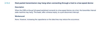

we have many customers using STM32F4 as USB host and connecting a HUB using partners Hub class, the only known limitation at the internal PHY Full speed is to not connect a Low speed device as specified in the silicon errata here .
 However if an external ULPI PHY is used for High and full speed it is working fine.

Won't increasing the capacitance of the data lines stress the silicon chip? How much is the value of the capacitor to be added in each line?
