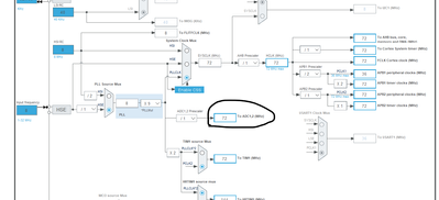

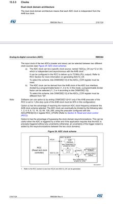

I would suggest to check the clock input to the fast ADC if it is 72MHz.
 Hope it helps,
STOne-32
vasudev
yes the ADC clock input is 72MHZ and also i am using fast adc channel .
