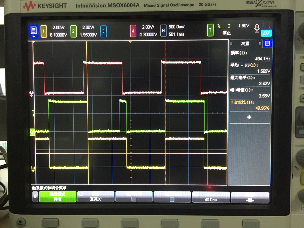

Background:
1. 1ms timer to trigger adc interruput;
if(htim->Instance == TIM1)//1mS timer
HAL_ADC_Start_IT(&hadc);
HAL_GPIO_TogglePin(
GPIOA
Pin_15
2. hadc.Init.EOCSelection =
ADC_EOC_SEQ_CONV
adc interruput callback function:
void HAL_ADC_ConvCpltCallback(ADC_HandleTypeDef* hadc)
if(__HAL_ADC_GET_FLAG(hadc,ADC_FLAG_EOC))
HAL_GPIO_TogglePin(GPIOC,Pin_8);
if(__HAL_ADC_GET_FLAG(hadc,ADC_FLAG_EOS))
HAL_GPIO_TogglePin(
GPIOA
,Pin_11);
3. MCU: STM32F072RB
When I use oscilloscope to check the adc time sequency, I find this odd:
Channel 1: PC8
Channel 2: PA11
Channel 4: PA15
At some moment, something triggered, the
ADC_FLAG_EOS is changed, and it should not appear.
