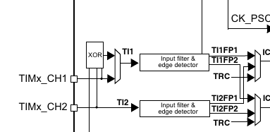

Or use a TIM pin where the CH1 / CH2 trigger on upposing edges of the TIMx_CH1 input pin (CH2 can use via Indirect Mode, ie criss-cross of CH1<->CH2, and CH3<->CH4)

A TIM should be able to cross​ connect one pin to two channels via indirect mode.
What is a TIM and how much added latency are we talking about?
AScha.3
TIM -> timer
