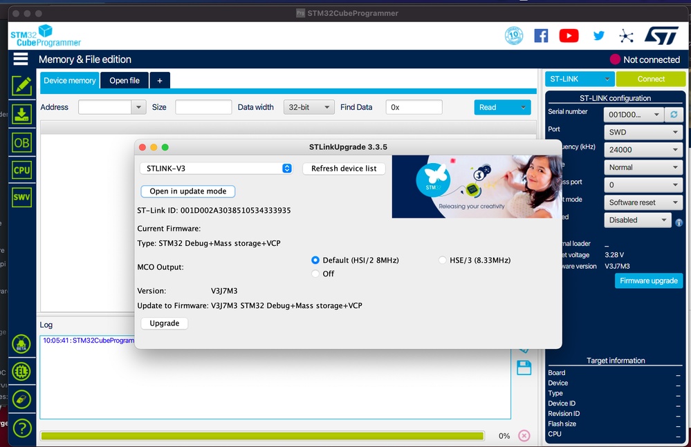

I'm having some trouble getting an accurate PWM signal from my H743ZI Nucleo board (MB1364C). It is off by about 1%. I am not using an external crystal, I am using the MCO signal from the F723 chip on the same board.
Am I just misconfiguring something? Or is the MCO signal not accurate? I need to generate a 1 ms pulse every 128 ms.
I appreciate any help or suggestions!

Remember Period and Prescaler are passed as N-1
Probably want 2048-1 to be On Frequency
Right, thanks. Good catch! I don't think that accounts for the ~1ms difference I'm seeing. And after fixing this, I'm still getting 992us on time and 125.998 ms off time

Short answer, yes, the MCO clock signal is no good - I tried routing the MCO clock signal from a different Discovery board, and I got the expected pwm signal
Thanks, just verified that it was the clock, and it is the ZI2
sirius506
FYI.
You can change the ST-LinkV3 MCO config to generate the clock from F723 HSE.
But, resulted clock freq becomes 8.33MHz (sigh...)
thanks, that will come in handy!
