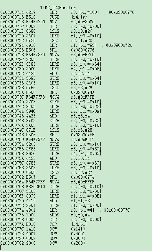

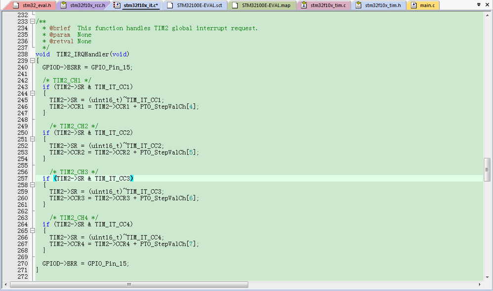

360804365
Posted on April 16, 2015 at 03:39
This is one of my ISR,and the current interrupt rate is 40KHz(4 channels will interrupt concurrently).I got the execution time by measuring the pulse width on PD15 and don't know why the pulse was a little wider when I placed all the ISR code and data in internal SRAM.
360804365
Posted on April 16, 2015 at 03:46
This is the disassembly code from my ISR posted previously and the branch instructions seemingly are 4 and not 3.@clive1
