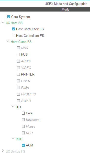

I'm looking to implement USB host functionality on an STM32C071 to connect with a single device that sends/receives serial data over USB so the only class I'm interested in is CDC, but I'm having trouble using USBX (I'm not using RTOS).
For now I haven't used and read/write functions, my goal was to start by checking the functionality of the callbacks inside "app_usbx_host.c" which are: device inserted/removed/connected/disconnected, enumeration fail and no USB device found. Each one sets a different flag to be handled inside the main loop.
I put a breakpoint inside the USB IRQ and when I connect the USB device it stops execution and confirms the breakpoint has been reached, however none of my flags are ever set,.
I suspect the reason might be because I haven't done anything to link the USB peripheral to the USBX stack, if the function responsible for that is ux_host_stack_hcd_register, I have no idea how to use it. The function prototype is:
UINT _ux_host_stack_hcd_register(UCHAR *hcd_name, UINT (*hcd_init_function)(struct UX_HCD_STRUCT *), ULONG hcd_param1, ULONG hcd_param2);
I'm completely lost in the description for each of the arguments.

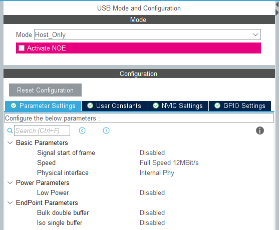

static void MX_USB_HCD_Init(void){
  hhcd_USB_DRD_FS.Instance = USB_DRD_FS;
  hhcd_USB_DRD_FS.Init.dev_endpoints = 8;
  hhcd_USB_DRD_FS.Init.Host_channels = 8;
  hhcd_USB_DRD_FS.Init.speed = USBD_FS_SPEED;
  hhcd_USB_DRD_FS.Init.phy_itface = HCD_PHY_EMBEDDED;
  hhcd_USB_DRD_FS.Init.Sof_enable = DISABLE;
  hhcd_USB_DRD_FS.Init.low_power_enable = DISABLE;
  hhcd_USB_DRD_FS.Init.vbus_sensing_enable = DISABLE;
  hhcd_USB_DRD_FS.Init.bulk_doublebuffer_enable = DISABLE;
  hhcd_USB_DRD_FS.Init.iso_singlebuffer_enable = DISABLE;
  if (HAL_HCD_Init(&hhcd_USB_DRD_FS) != HAL_OK) Error_Handler();

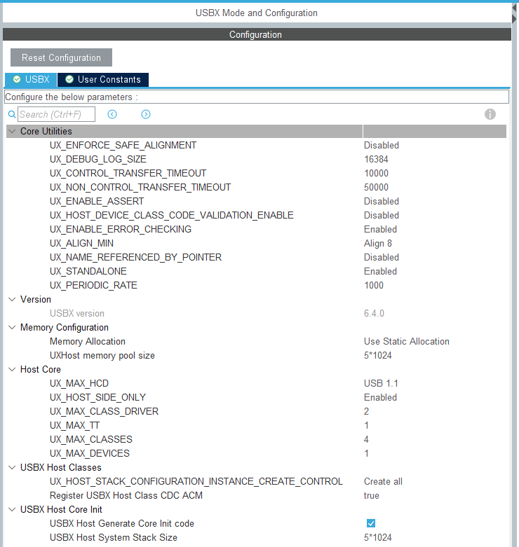

The images below contain the CubeMX settings I used.
USB peripheral configurationUSB peripheral configuration
Class configurationClass configuration
USBX configurationUSBX configuration

You need to ensure initialization the USBX host stack, ensure it has enough memory, and poll its task function in the main loop. MX_USBX_Host_Init() must be called after MX_USB_HCD_Init() so the USBX host stack can properly register and link to the USB peripheral.
MX_USB_HCD_Init();        // Initialize the USB host controller
MX_USBX_Host_Init();      // Then initialize the USBX host stack
In your main loop, you also need to call ux_system_tasks_run(); and poll on your CDC task.
