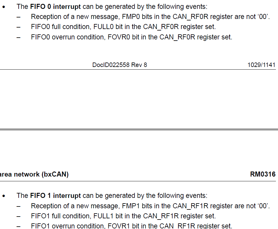

Hi everyone,
I'm working with the MCU STM32F303 and the Reference manual says the following:
So I'wondering if it would be possible to manage both interrupts separately with CAN_IT block. Currently with the block it seems that it's only possible to generate one interrupt associated with any receiving message at any mailbox.

‎2020-11-10 5:43 AM
Hi @Rubén Gálvez​
Yes, it's only possible to generate one interrupt associated with any receiving message at any mailbox/by FIFO. ie. one interrupt for FIFO 0, one interrupt for FIFO 1.
But it can be managed at application level.
