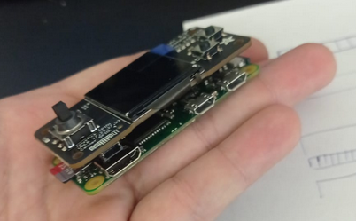

‎2021-11-03 6:17 AM
At the moment my client just needs to plug the thing and flashes automatically, no need to have touch functionality nor OS navigation.
(i could access trough ssh if needed)
The screen just gives a very rudimentary one direction GUI, it feels alive and expensive that way.
You could also get away with a small piezo that goes BEEEEP or BEP BEP.
