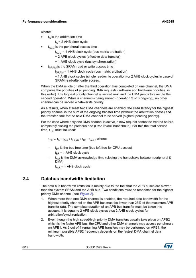

Posted on October 22, 2017 at 22:33
how many clock cycles to update the set of the registers by each DMA transfer,I can't get the clear informtion from ST datasheet , from
 the table 83 of Referece manual ''RM0364'' , I guess it is 3 cycles at 72MHZ
More like 6 AHB + 2 APB cycles, if there's no collision with other masters on the buses and no other DMA channel active - this might be a showstopper.
I know AN2548 is for 'F1 and 'L1, but the DMA in 'F3 appears to be of the same design.
I'd recommend you to write a simple test application, perhaps on a Disco or Nucleo, before commencing with design. Using external modulator as Clive suggested above is always a sure bet of course.
J L
Posted on October 23, 2017 at 05:52
Thanks JW,
How many latency cycles at HRTIM DMA on STM32F334 , hope to get  the ST official answer soon ...
