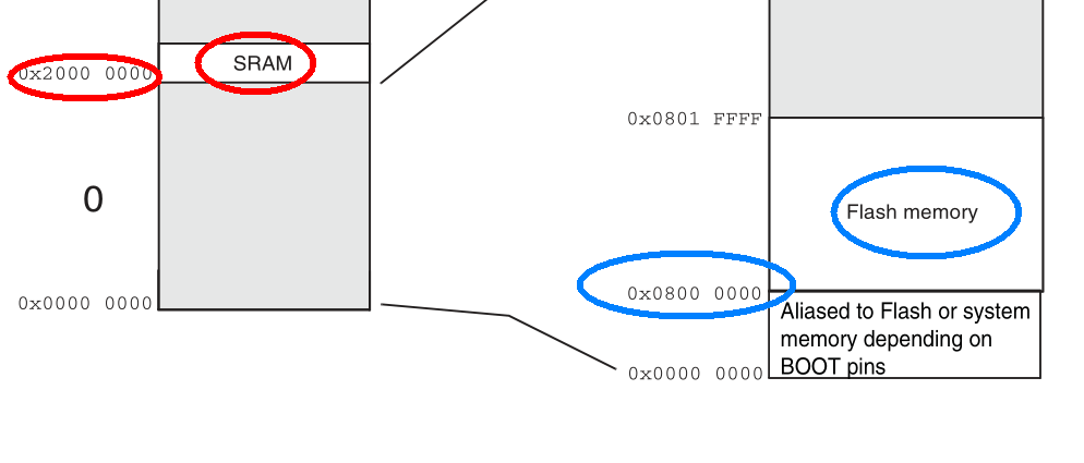

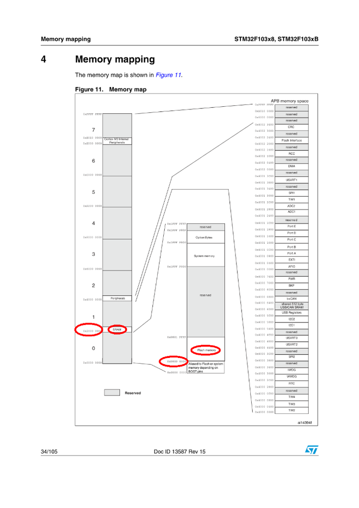

In STM32F103RB, what is the first addressable byte in SRAM and Flash?
Muzahir Hussain
Posted on October 21, 2017 at 12:28
What is the first byte in SRAM and Flash memory that I can write to.
#stm32f103xx
2 REPLIES 2
waclawek.jan
Posted on October 22, 2017 at 22:38
Posted on October 22, 2017 at 22:42
