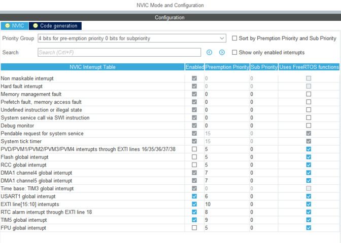

Hi, its not clear for me, does lower number represent higher or lower priority?
Is "System tick timer" at highest or lowest priority?

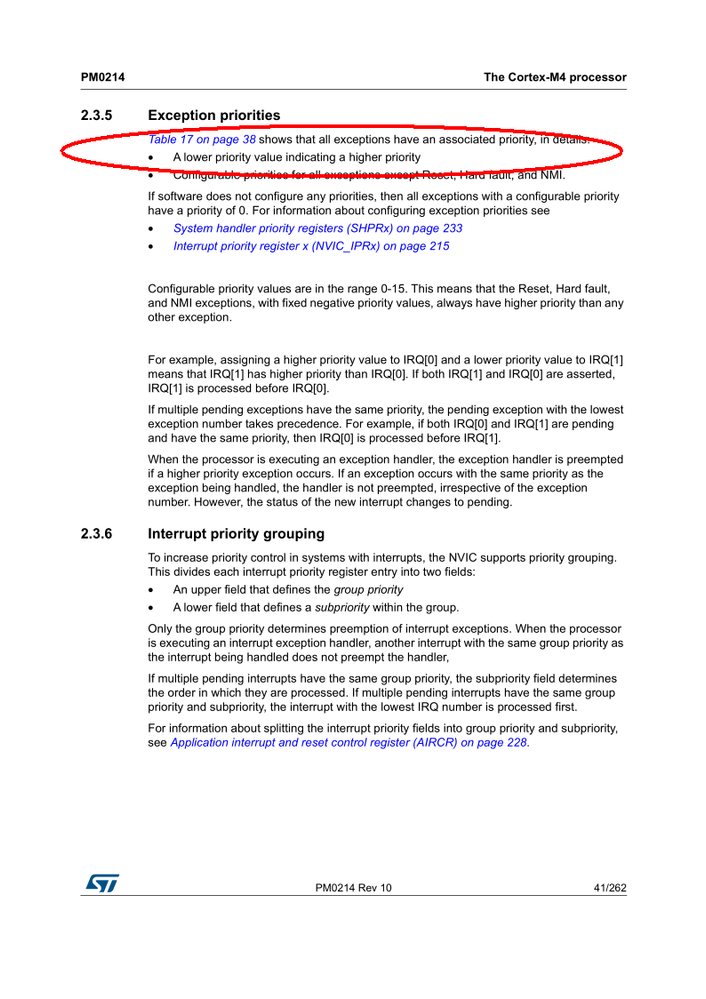

0693W00000Dq4coQAB.pngJW
