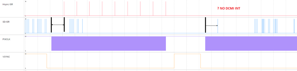

I have the DCMI camera interface on a STM32N6 streaming to the SDCard, and I am noticing that there are cases that the DCMI reports an Overrun when a SD access occurs at the same time that the Hsync interrupt was meant to occur.
Digging into it I believe its due to congestion on the underlying AXI bus, and the IDMA of the SDMMC taking priority over the DCMI DMA. I have set the DCMI and its DMA to the highest possible priority as below.

Yes I am quite certain I am operating within those bounds, as the camera streams successfully for a long period of time, until there is a contention with the SDMMC.
It is a rare occurance I am seeing every few hours, however it is reproducible.

Basically it appears that the DMA is getting stalled in these cases,  until the DCMI Overrun flag is cleared.
What happens at the bus level when an interrupt from the SDMMC triggers the AHB, and then shortly after the DCMI triggers the AHB? I'm assuming the SDMMC hold the bus until it's done?
I know N6 has different bus architecture, but when doing similar thing and with another simultaneus stream on H7R, the solution against congestion was to unload everything else from the AXI and AHB buses. All code and ISR tables in ITCM, all data and stack in DTCM, no peripheral register access or interrupts were allowed, except DMA final 2D sequence completion or error. Even circular and linked list DMA solutions failed as it had to access registers after each block. Only systick, as it's tightly coupled to CPU, was okay to interrupt.
The problem was/is that at least H7 DCMI has tiny FIFO and bus access wait time longer than few clocks causes overrun. So bus has to be kept free.

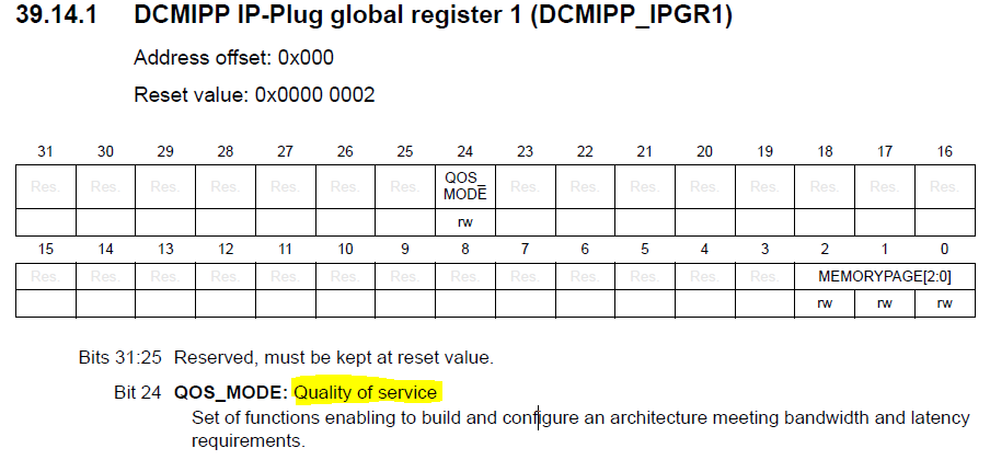

My next plan of action is to replace the DCMI implementation I have with the DCMIPP.
The latter has a 5120 byte FIFO versus the 8 word FIFO of the DCMI.
Hopefully then if a long SD Card transaction takes place, then at least the  larger FIFO can tolerate it.
Another option is to reduce the SD transaction size.
I see that the DCMIPP also has a QoS for the AXI bus. Does this mean it would be given priority at a bus level if a SD transaction was already underway?
However the manual (RM0486 Rev 3) is vague on how this QoS is used, besides:
