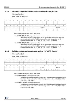

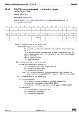

The RM briefly mentions values for PMOS and NMOS transistors to presumably control slew rates, but I cannot find any data on how to determine the bit values.
There is a function, HAL_SYSCFG_CompensationCodeSelect(), but again there are no examples of its use.  Google also shows no example code!

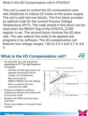

Dear @Robmar ,
We introduced I/O compensation cell for our first 90nm Process technology for STM32F2 and F4 and then we maintained it for high speed and high performance lines such as H7 and recent platforms. Basically we can summarize this feature ( design process - not easy to see the impact for typical devices ) that it operates in opposite way as I/O digital Output speed and will reduce and compensate the fast process ( fast transistors) in automatic way for user . For more details see this slide 8
https://www.st.com/content/ccc/resource/training/technical/product_training/group0/29/35/ae/de/59/26/4c/e4/STM32H7-System-General-purpose_IO_interface_GPIO/files/STM32H7-System-General-purpose_IO_interface_GPIO.pdf/_jcr_content/translations/en.STM32H7-System-General-purpose_IO_interface_GPIO.pdf

SW application do not have to know how to set that . It is internal hard block by design and sets in automatic way for user application. The most important to set the feature only .
That isn't what the documents explains, is states there are two methods, but how to select between them? There is a great lack of code details.
Page 8 of :- en.STM32H7-System-General-purpose_IO_interface_GPIO.pdf
• Two configuration modes are available:
1. Using the optimal configuration code calculated by the cell for the temperature
current PVT voltage).
This code is generated and the READY flag is set when the CSI clock of the
cell is enabled.
2. Using software programmed code to control I/O response speed.
Hi @Robmar ,
thanks for the clarification, indeed here is how te set them in the reference Manual ,
My recommendation for software to rely always on the hardware automatic way , the manual one can be used only for debug purposes as each code is part to part dependent and acts on each Unique MCU in a different way based on the PVT ( Process, Voltage and Temperature) to keep controlled skew rate . After reading the automatic way , we can then change the Code ( Read only ) with increment/ decrement as see the effect .
hope now more clear .
