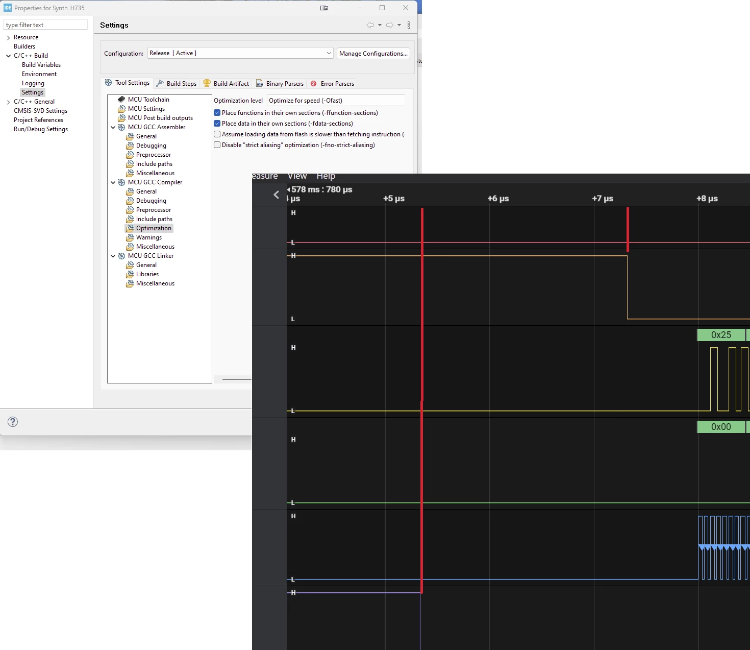

Using a stm32h7
From what I gather this 1.5 responce tie is normal. Is there a trick or two I can use to speed this up? Can I move the callback location in memory? I'd like to get this much closer to a a few ticks.

December 6, 2022
Code is generate by ioc, it should all be standard. I'm using the HAL
pin config was generated with
 /*Configure GPIO pin : PF14 */
 GPIO_InitStruct.Pin = GPIO_PIN_14;
 GPIO_InitStruct.Mode = GPIO_MODE_IT_FALLING;
 GPIO_InitStruct.Pull = GPIO_PULLUP;
 HAL_GPIO_Init(GPIOF, &GPIO_InitStruct);
call back is just
void HAL_GPIO_EXTI_Callback(uint16_t GPIO_Pin)
Test_Execut_start_GPIOG4; //used for debug trace
Test_Execut_stop_GPIOG4;
 if (GPIO_Pin == GPIO_PIN_14)
 //do code
but from the time the int fires to the code its nearly 1.5us.

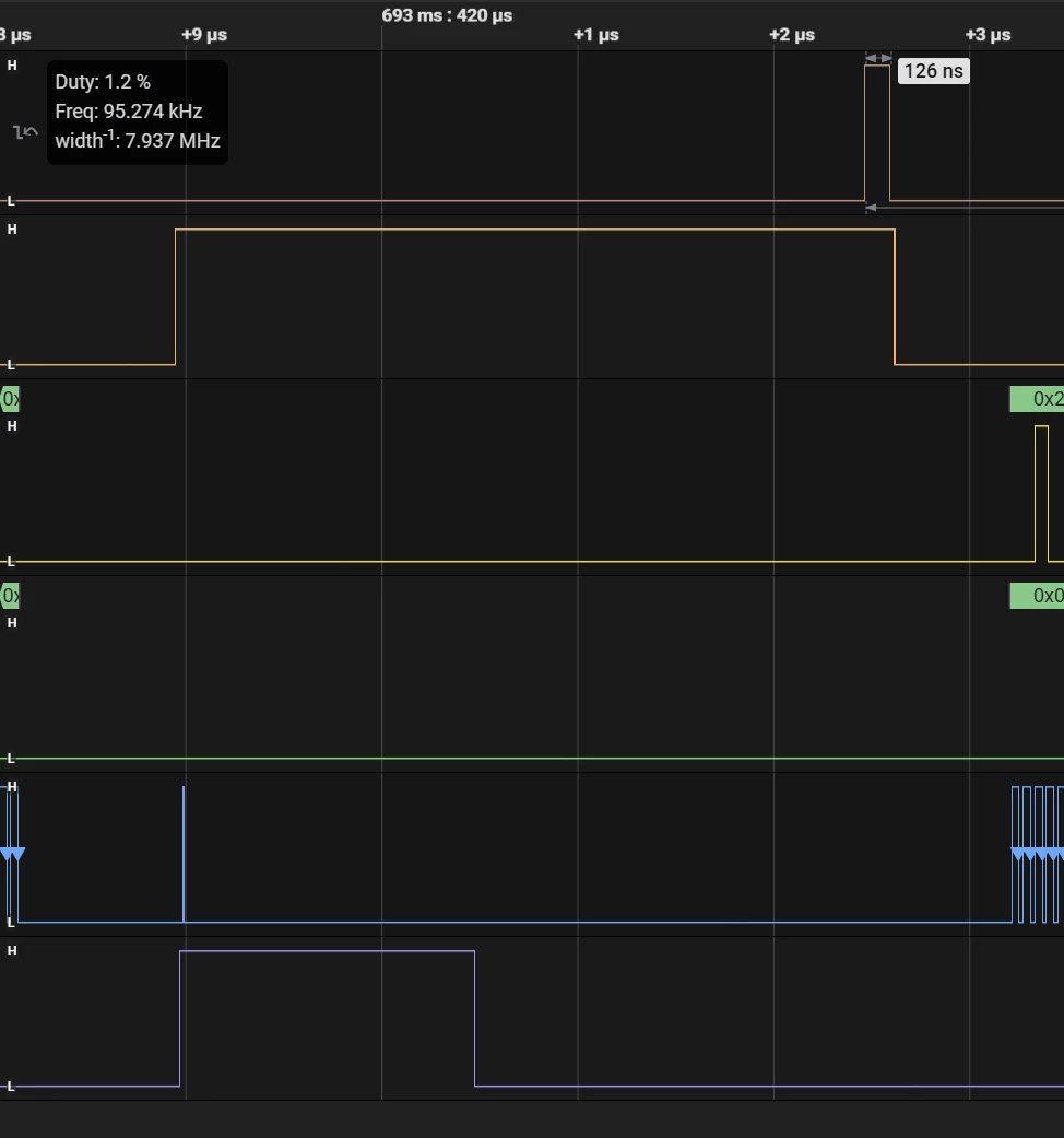

ulao
ulaoAuthor
December 7, 2022
its saved me a whopping 126 ns
void EXTI15_10_IRQHandler(void)
 /* USER CODE BEGIN EXTI15_10_IRQn 0 */
 /* USER CODE END EXTI15_10_IRQn 0 */
 HAL_GPIO_EXTI_IRQHandler(GPIO_PIN_14);
 /* USER CODE BEGIN EXTI15_10_IRQn 1 */
 /* USER CODE END EXTI15_10_IRQn 1 */
ulao
ulaoAuthor
December 7, 2022
ok unlesss 1us is not enough time for the st to re arm the irq I think I the issue is code related. it seem to fire correctly the first time.

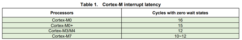

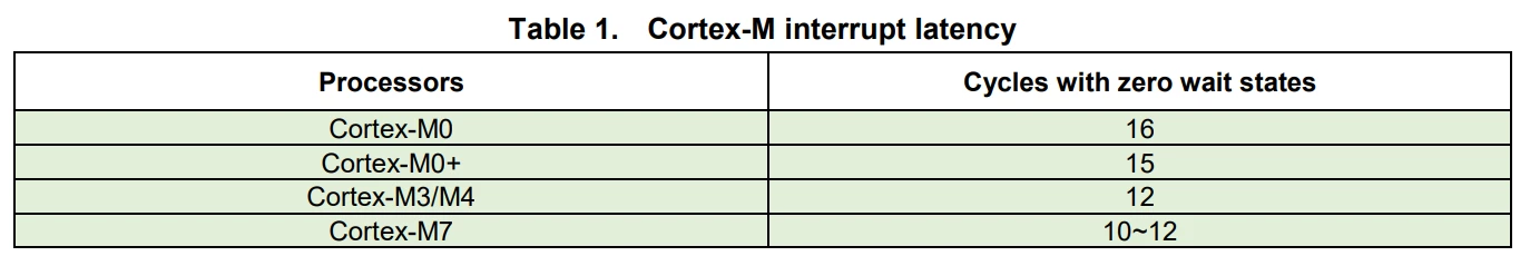

MM..1
Chief III
December 7, 2022
0693W00000WKSxiQAH.pngFor 12 and 180MHz for example 66,6ns plus interrupt init instruction cycles...
ulao
ulaoAuthor
December 7, 2022
yeah my issue was code related , and thx for that table.
