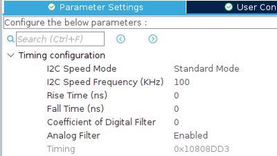

plz tell me how to enable filters for i2c
here analog filter on, + dig.filter : if you wanna use, just set it: 0...15 possible.
