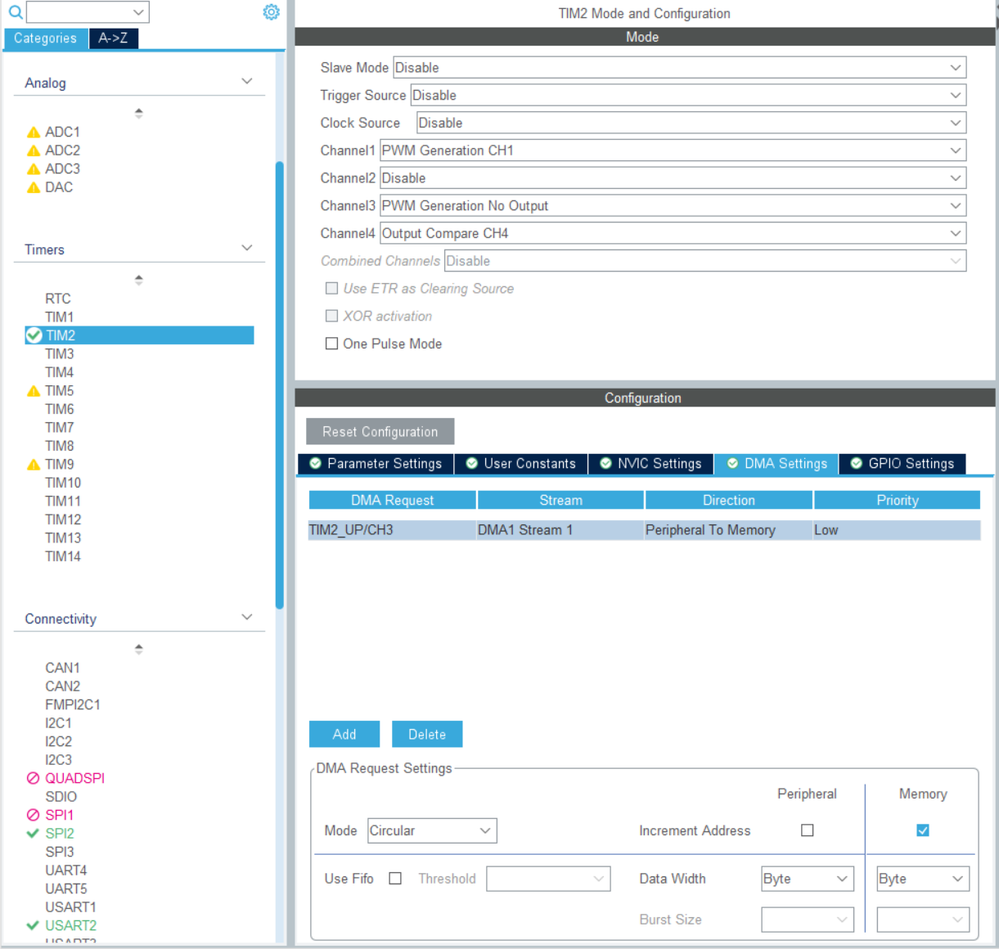

Below is how the DMA is configured for the timer (to receive from SPI):
[In DMA request, I can only select TIM2_UP/CH3, instead of TIM2/CH3 in your screenshot]

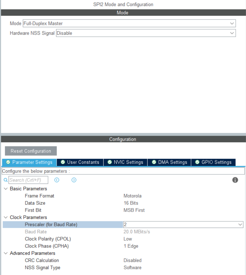

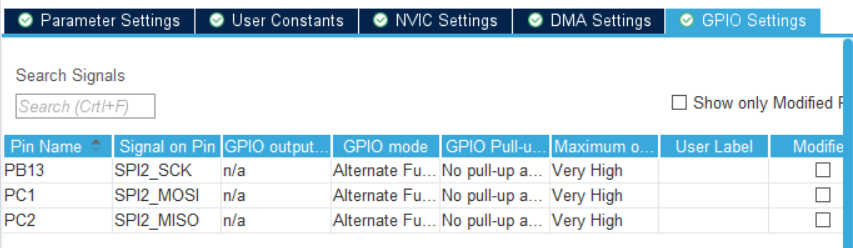

0693W00000KZyv7QAD.png0693W00000KZyx3QAD.pngMy SPI is configured as below:
0693W00000KZyvRQAT.png0693W00000KZywZQAT.pngThe following code:
[I swapped the SPI2->DR and buffer around (line 3-4) since I want to receive, not transmit, I believe this is correct. Am I perhaps not correctly setting a register in the SPI module to initialise it for receiving?]

I am probing PB13 and expecting to see a clock when channel 3 timer triggers, but it is stuck low.

Works for me. Found my Nucleo F446RE board and setup as you did. Have attached my .ioc file, copied your code.
Only difference: DMA should transfer half-words (16-bit), not bytes.
You may set CH3 to output its pulse on a pin and probe that too.

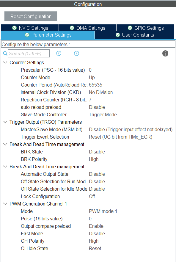

Ok, next plan, no code yet. If the 2nd SPI is slave, why not put both in slave mode (with circular RX DMA)? Then, we need another component, generating the clock pulses. This could be Timer TIM1 in one pulse mode and using a repetition counter of 7 (for 8 pulses). The pulse train (clock) is output in PWM GenerationCH1 mode.
How to trigger TIM1? Manually, for testing, worked.
Next: Automatically from TIM2. (Put TIM into slave trigger mode and route the TIM2 event to TIM1 ITR.

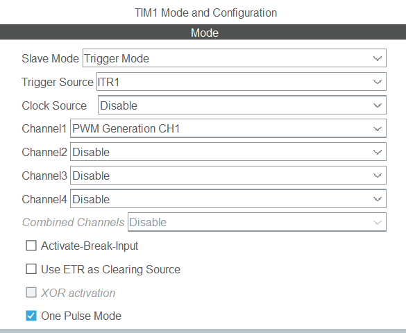

Hi KnarfB, I'm not able to get the one pulse mode working on TIM1. I have tried many settings but can't seem to get anything out.
I have got TIM1 triggering on TIM2 working (when I set TIM1 channel 1 output to something that isn't using the OnePulse mode). From the reference manual, TIM2 can trigger TIM1 using ITR1.
I am using line 1 of the code below to try to start the one pulse functionality on TIM1:
HAL_TIM_OnePulse_Start(&htim1, TIM_CHANNEL_1);
HAL_TIM_PWM_Start(&htim2, TIM_CHANNEL_1);
HAL_TIM_PWM_Start(&htim2, TIM_CHANNEL_3);
Below is an example of the type of setup I am trying for TIM1 (I have verified that the trigger mode is working, but also tried one pulse with trigger disabled):0693W00000Ka5iKQAR.png0693W00000Ka5j3QAB.pngThank you!

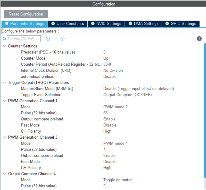

Looks promising. For TIM1 Clock Source set Internal Clock. Counter Period to 2 (something small) and CH1 PWM Pulse to 1 (not 0).
TIM2 is as yesterday with TRGO Trigger Event Selection to OC3REF.
In main() just start both timers.
HAL_TIM_PWM_Start(&htim1, TIM_CHANNEL_1);
I get the clock pulses.
