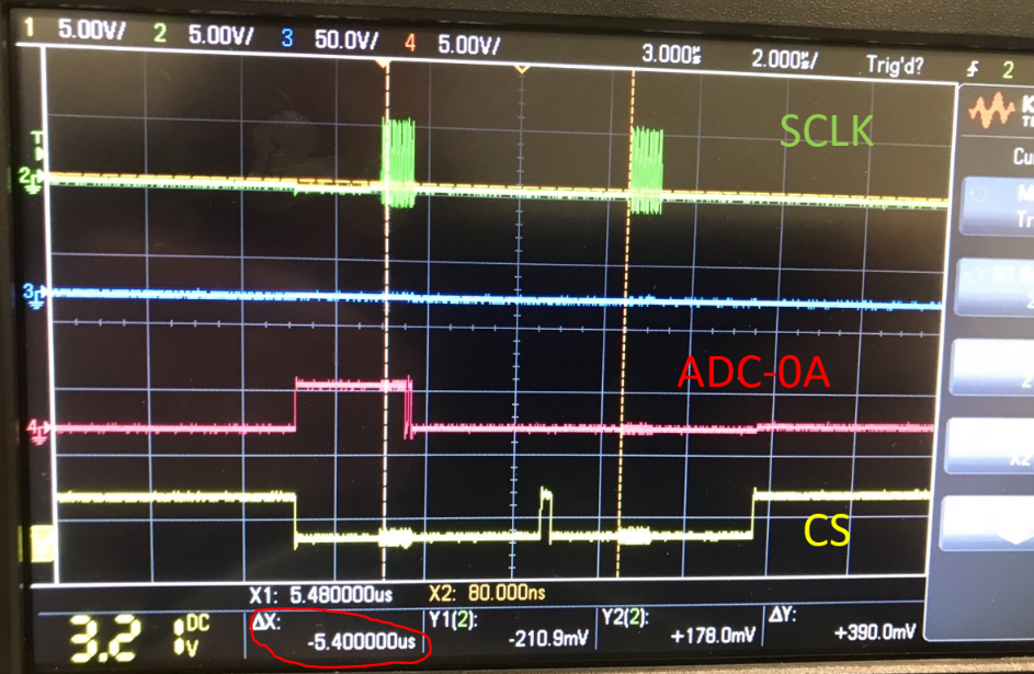

Hi all,

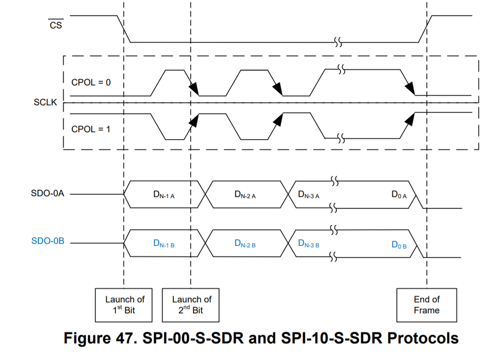

I am using the NUCLEO-F446RE with the STM32F446RE. I am trying to interface with an external dual sampling differential ADC: ADS9224R.
ADC Timing Diagram
0693W00000KZlwCQAT.pngThe ADC can provide samples at up to 3M/s. I would be happy to achieve ~0.8M/s sampling.
I have been struggling to meet the timing that I require and can only reach ~180kHz with the STM32. My problem is that initiating separate SPI receive calls takes too long between commands.
Running the following code to initiate back to back SPI reads:
HAL_GPIO_WritePin(GPIOB, GPIO_PIN_6, GPIO_PIN_RESET); //CS LOW
 HAL_SPI_Receive(&hspi1, (uint8_t *)spi_buffer, 1,40);
 HAL_GPIO_WritePin(GPIOB, GPIO_PIN_6, GPIO_PIN_SET); //CS high
Produces the following timing:
The STM32 is operating at 180MHz, and the SPI CLK is at ~30MHz. You can see that once the SPI initiates it is very fast, but the time to initiate the next SPI read is taking too long (~6us) which is limiting the rate at which I can read from the ADC.
I understand that this approach will only read ADC-0A, and not ADC-0B simultaneously. I have an implementation that uses QSPI but suffers from the same problem. I have simplified to single line SPI in hope that more people can provide help and I can transfer this to a dual line implementation.
Thank you all for your help!

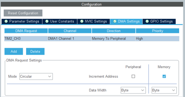

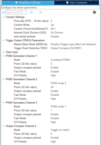

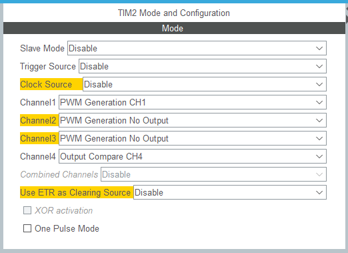

Best answer by KnarfB
Ok, next plan, no code yet. If the 2nd SPI is slave, why not put both in slave mode (with circular RX DMA)? Then, we need another component, generating the clock pulses. This could be Timer TIM1 in one pulse mode and using a repetition counter of 7 (for 8 pulses). The pulse train (clock) is output in PWM GenerationCH1 mode.
How to trigger TIM1? Manually, for testing, worked.
Next: Automatically from TIM2. (Put TIM into slave trigger mode and route the TIM2 event to TIM1 ITR.
Don't have that ADC for testing.
Soon more...
