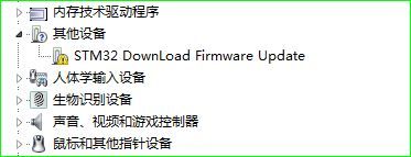

I wanted to test DFU function with my STM32F401 board, and my Win7 has installed DfuSe V3.0.4. After I plug USB to PC, it shows the driver is not corrected, so DfuSe can't recognized the USB device.
I searched the forum but havn't find a solution, can anyone give some advices? thank you very much!

You can find the screen shot here:
Posted on August 11, 2015 at 04:41
Have you tried with a STM32F4-DISCO board? Did that work?
You have BOOT0 pulled High? You have an 8 MHz HSE crystal?
The board otherwise works and you can connect with SWD debugger, and tested code?
Does the USB work with a VCP or MSC example?

Today I tried system bootloader:
I set BOOT0 as 1, BOOT1 as 0 and connected to PC, it can show''STM32 Bootloader'', however, it still can't find the driver:-(
Posted on August 13, 2015 at 18:10
Do you have any settings/policies in your Win7 install that might preclude the loading of drivers, or expect them to be signed etc? Are you an Administrator on the machine? Do you have IT people responsible for the machine?
Having installed the DFU software, there should be a driver directory, run the explicit installer if you need too.
C:\Program Files (x86)\STMicroelectronics\Software\DfuSe\Driver
Does Windows provide a specific error? Or just that it can't/won't load the driver?

It'm my computer's problem. I used another PC just now, and successfully upgraded my board through system DFU bootloader now:-)
